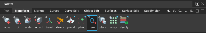

Resets any scaling, translation (movement), and rotation applied to the picked objects.
Access this tool from the Transform tool palette:
