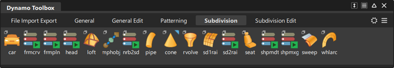

  1. The easiest way to load a script into Dynamo Player, is to select it from the Dynamo Toolbox. To open the Dynamo Toolbox, do either of the following:
    • If Dynamo Player is open, click the icon.
    • Select Help > Dynamo Resources > Dynamo Toolbox from the Alias main menu.
  2. Click the icon of the script you want to load.
    If the script you want to run is not available from the Dynamo Toolbox, click the browse icon, and then browse the Dynamo Player folder located in your Alias installation directory. For example:

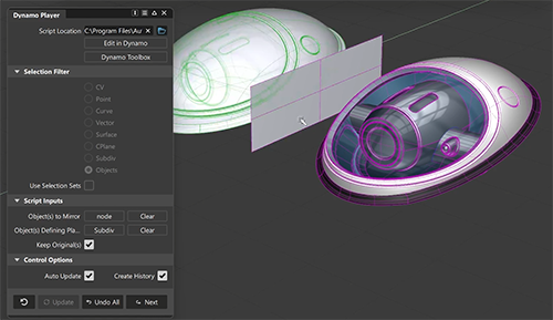

Mirror-by-Object(s)-2025.0.1-mrbobj.dyn /Mirror-by-Plane-2025.0.1-mrbpln.dyn
These scripts mirror input geometry across a plane based on a given planar surface. This is an easier workflow than the native Alias mirroring tools. In this case, the mirror planes are not the standard ones (XY, YZ, XZ).

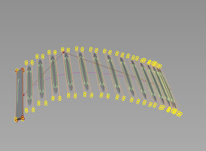

Manekin 2024.1.1.76-mankn.dyn
Creates a full body manikin from subdivision geometry, with rotating joints on the neck, torso and limbs. Position the geometry using a construction point or at the viewport origin (X=0, Y=0, X=0). Use the script controls to specify the height and orientation of the manikin as well as to rotate the limb joints to pose it.

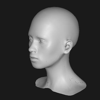

Modular Headshape 2024.1.1-modhd.dyn
This script creates a head model from .tss t-spline subdivision geometry. The script controls allow you to make variations of head and facial features by adjusting characteristics, such as gender, age, and more. Use the head model as a reference object in Alias.

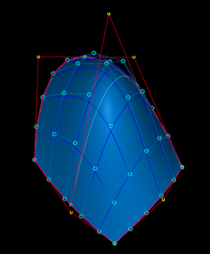

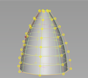

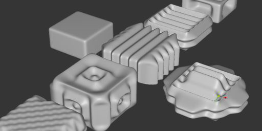

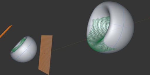

Nurbs Surfaces on Revolved Surface(s) 2024.1.13.dyn
This script creates multiple NURBS surfaces on revolved surfaces. These surfaces are arranged in rings and can be optionally staggered. Set the surface width and height using the script controls or by selecting a reference surface.

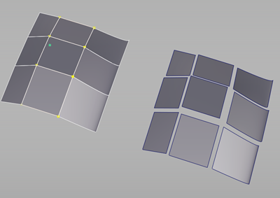

Nurbs Surfaces on Surface(s) 2024.1.10-sfonsf.dyn
Creates surfaces on a target surface using specified construction points for position and a construction plane for orientation. Use the results of this script as a target reference for the Feature Modifier tool.

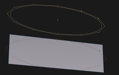

Nurbs Rectangular Surface from Curves crv2sf.dyn
This script creates a NURBS planar surface from a curve or surface edge inputs using a best fit plane method. Use this script to create a source reference for the Feature Modifier tool. This output of this script create geometry that is similar to that of the Set Planar tool, but it does not create a trimmed result.

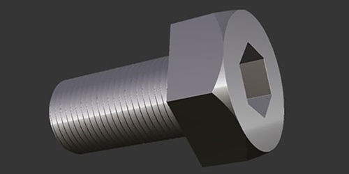

Bolt Generator (2024.0.1)
Use this script to generate a variety of bolts from NURBS geometry. You can choose presets for M3 to M8 standard bolts or make your own using the parameters exposed in Dynamo Player. The script creates one bolt at the location of a construction point input.

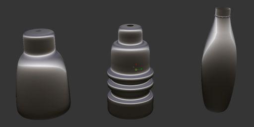

Flacon Generator (2024.0.1)
This script lets you create a flacon or bottle. Use the parameters to change the fill level and add a fluid object inside volume. The resulting geometry can be a NURBS surface or subdivision object.

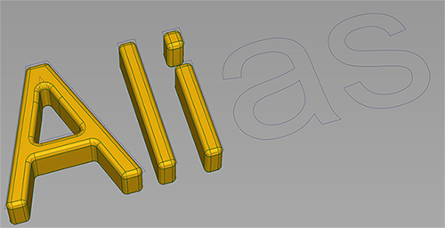

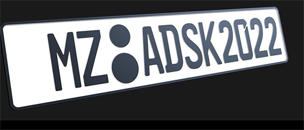

License Plate Generator (2024.0.1)
This script creates license plate geometry for the front and back of a car. Two construction points are used as inputs for the plates. The position of the front plate, which is oriented to the x axis, is defined by the first point. The second point creates the back plate.
Use the Text tool (Curves > Text) to create the 3D text objects for the license plate text. Select the text objects as the inputs in the Select 3D Text + Numbers section.
If the text is oriented in the wrong direction, select an options from the Rotate Text to correct it. You can also choose between creating plates with a single line or with two lines.
Tip: Use the DP-Nurbs-Closed-Curves-to-Solids.dyn script to convert the plates to solid objects.

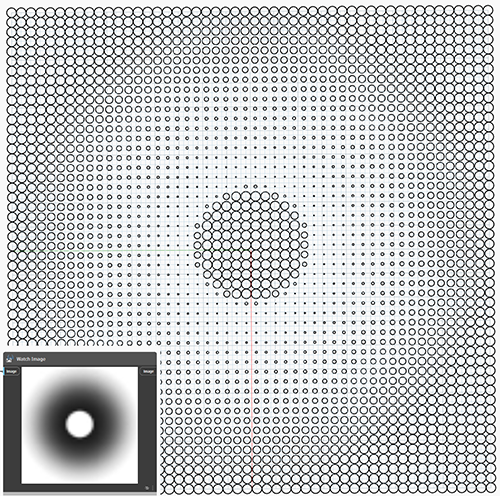

Modify by Picture (2024.0.1)/MS Modify by Picture (2024.0.01)
These scripts provide examples of how to translate the black and white values of an image into the scaling values of a rectangle polygon. Use the parameters to define image resolution to use. It is recommended that you set the resolution to values that are lower than the source image.
The MS Modify by Picture (2024.0.01) lets you generate the pattern on multiple surfaces.

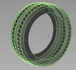

Nurbs Tire (2024.0.7)
This script creates a NURBS model of a tire at the location of a construction point (Construction > Point). Select the point, and then click Accept before clicking Build.
Tire size and shape
Use the Tire and Shape parameters to fully customize the tire's specifications, including rim size, cross-sectional width, and height-to-width ratio. The resulting tire geometry is made up of multiple surfaces. This allows you to add different textures to the surfaces, such as a side wall label or tread patterns.
Create the tire tread
After you've created a tire with the desired specifications, you can generate a tire tread. In the Tread parameters section, you can select either Standard or Custom as the Create option. Select Standard to generate a tread pattern based on the set Standard Tread parameter values. Select Custom to use curves to generate the tread pattern. Use the Custom Tread parameters to make adjustments to the pattern.
When creating a tread using custom curves, ensure the curves are located above and in close proximity to the tire geometry.
Preview the design
Turn on Preview mode while you adjust the tread parameters to create your tread design. The preview lets you view your tread design before generating the geometry. When you are satisfied with the design, turn on Create 3D Tread to generate the tread pattern geometry on the tire. Note that the tread generation may take between 40 and 90 seconds to complete.

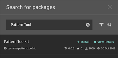

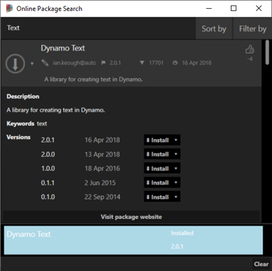

To add text for dimensions or other information in the viewport, you must install the Dynamo Text package in Dynamo. To do this:
  1. Open Dynamo, select Packages > Search for a Package, and then type text into the search area.
  2. Select and install the Dynamo Text package.

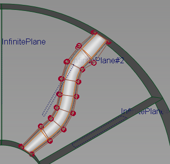

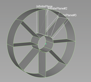

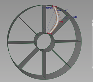

Rim Support and Radial Scaling
You can use this script to aid in the design and creation of wheel spoke geometry. Executing this script generates reference rim geometry, including symmetrical regions inside the rim, which are intended to guide the scale and position of the resulting spoke geometry. You can generate the reference rim geometry a location of construction point or at the origin of the viewport (X=0, Y=0, Z=0).
Note: In this case, the term reference does not refer to WREF geometry.
About the reference geometry and script parameters
  • Three construction planes are included for the purposes of helping you shape your spoke geometry.
  • Use the Rim Dimension parameters to scale the reference geometry.
  • Sectors refer to the symmetrically spaced regions between the outer and inner rim of the reference geometry. Spokes get generated inside each sector.
Using this script is a multi-step process that includes the following suggested workflow:
  1. Select the construct point located where you want to generate the rim and spoke geometry. If you do not select a construction point, the geometry gets generated at the viewport origin (X=0, Y=0, Z=0).
  2. After loading the script, click accept to generate the reference rim geometry.
  3. Adjust the scale and dimensions of the reference rim geometry.
  4. Specify the number of sectors in the reference rim geometry by setting the Amount of Sectors and Reference Sector Count to the same value.
    The script uses these values to ensure that the spokes will be symmetrically scaled and positioned when they are generated from the source subdivision body.
    Note: At this stage, the Amount of Sectors and Reference Sector Count values must be the same, otherwise the script cannot accurately calculate the symmetrical spacing of the spokes. Later, you can use the Amount of Sectors to adjust the number of spokes, but do not modify the Reference Sector Count value after this step.
  5. Create the subdivision geometry you want to use for your spoke. For example, you can use a subdivision pipe created from the Subdiv-Pipe-2021.2.2.dyn script or any other subdivision object.
  6. Position and align the subdivision body inside the sector containing the construction planes. The top of your subdivision body should be flush to the inner surface of the outer rim, and the object's bottom flush to the outer surface of the inside rim.
  7. In the Spoke section, click the Select Subdiv and pick your subdivision body.
  8. Click Accept.
    The script generates a new spoke in each sector around the rim.
  9. Set the number of spokes by adjusting the Amount of Sectors parameter.
    Tip: To only display your spoke geometry, you can either hide the reference geometry, or turn off Create Rim Sectors and Create Symmetry Plane.
Tip: Since construction history is created with the script, any edits to the shape of the source subdivision object automatically get applied to all the spokes.

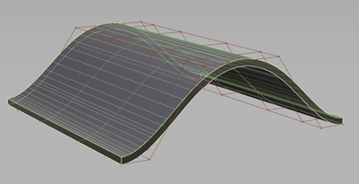

Thicken
Use this script to add thickness to NURBS objects. For the script to work correctly, the geometrical normals on the surfaces must be aligned. Use this script to add material thickness to surfaces instead of using the Surface Offset tool.
Note: The thicken surfaces can be stitched, however you may need to increase the Tolerance value of the Stitch Control Construction options.

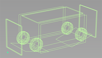

Wheel Placement (2024.0.7)
This script takes selected geometry, such as a wheel or rim, creates four copies, and then places the objects at the wheel positions of a car. Wheelbase, Track Width, and Offset parameters let you adjust the wheel placement to the specifications of your car models. Use this script to quickly place tires created by the tire generation (DP-Nurbs-Tire.dyn) script. This script may run slowly when you select large amounts of geometry.

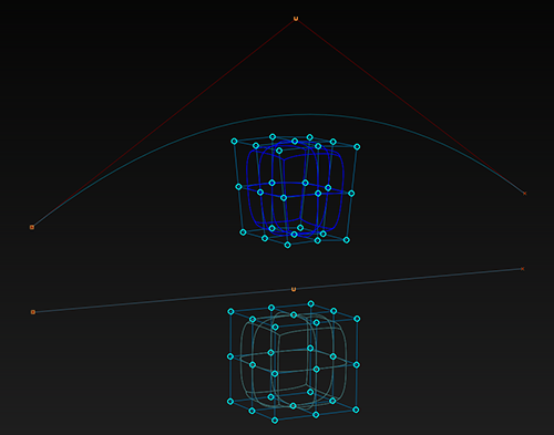

Nurbs Curve morph by Curve (2024.0.4)

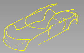

This script moves the CVs of a NURBS curve based on the difference between a static reference curve and a modified version of reference curve.

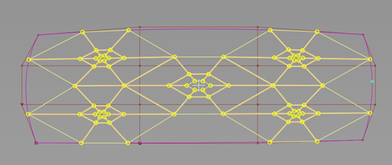

Scale by Points (2024.0.2)
This script takes input geometry, and then scales it from a provided center point, based on two more input points.

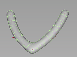

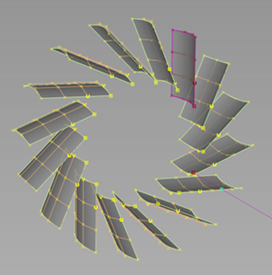

Subdivision Pipe Pattern 2025.0.1.dyn
Creates a hexagonal pattern of entwined pipes on the selected input surface.

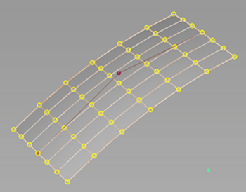

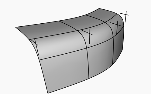

Nurbs Surface from Curve 2025.0.7-sfbycv.dyn
Using a NURBS curve as guidance, this script creates a NURBS surface of the wanted dimension on one or more target surfaces. This created surface can then be used as Target Reference for the Alias Feature Modifier tool.

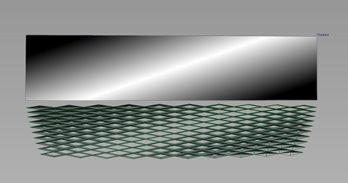

Create Picture 2024.1.11-crpic.dyn
This script creates a black-and-white picture from specified input surfaces. The selected surfaces display in white while the environment displays in black. An active construction plane determines the direction the picture is taken from. Modify the picture result, and then use the picture with the Place and Scale by Picture script.

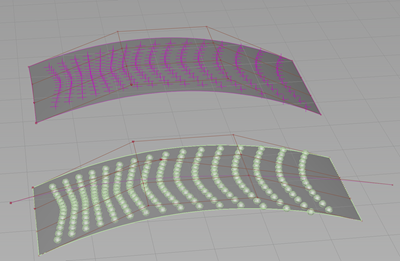

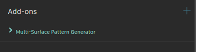

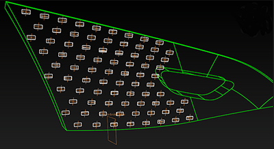

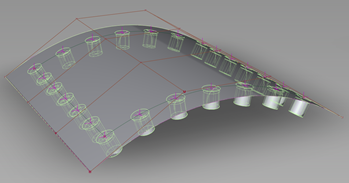

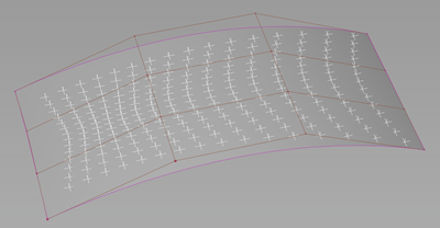

MSP 1 Curve (2024.0.3.89)
Use this script to place objects according to the points pattern onto one or more target surfaces. This script uses the following geometry from the Pattern Toolkit script as inputs:
  • Pattern Base Surface - Select the source NURBS surface that the points pattern was generated on.
  • Pattern Points - Select the points generated on the source surface.
It also includes the following additional inputs:
  • Guide Curve - This curve is used to specify the center point of the pattern on the target surface. Modifying the position or shape of the curve also affects the pattern on the target surface, such as compressing or expanding it.
  • Surfaces to Pattern - Select one or more NURBS surfaces as targets for the pattern.
  • Object to Place - Select the NURBS object you want to instance on the target surface.
This script also provides options for trimming the target surfaces and aligning the instanced to the normal.
Note: To use this script, you must have the Multi Surface Pattern Package installed in Dynamo. To verify that it's installed, look for it in Add-ons in Dynamo. For information about installing packages, start Dynamo, and then select Help > Interactive Guide > Packages from the Alias-Dynamo menu.

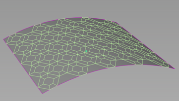

Nurbs Hexagon Pattern (2021.2.8)
This script uses a single NURBS surface as an input and creates a NURBS Hexagon pattern on it. Tip:
  • If you want to continue modifying the surface by modeling symmetrically, use Object Edit > Symmetric Modeling rather than using layer symmetry. Layer symmetry can invert the pattern.
  • When using this script on large surfaces, you may need to increase the maximum value range for the sliders. See Customize scripts for Dynamo Player.

Pattern Toolkit (2024.0.25)
Lets you quickly create basic patterns on NURBS surface planes. This script simplifies pattern generation and incorporates the more complex components of a patterning script in Dynamo, such as calculating linear distribution.
You can also populate the point positions with solid geometry, and then use the pattern to trim another surface.
Generate a point pattern
  1. Select an input surface as the Base Surface for the point pattern, and then press the spacebar or click Accept.
  2. Use the Pattern Parameters to choose from pattern types, such as a grid, circular, or diamond pattern and adjust the number of pattern points using the Amount U/ Rings and Amount V/Linear parameters.
  3. Use the Point of Influence and Attract/Detraction parameters to add non-linear distribution to the pattern. Use the Gravity slider to adjust the intensity. Switch between Linear and Radial attraction to produce interesting patterns.
Since the points pattern has history, scaling the surface affects the pattern. Use the DP-Multi-Surface-Patterning-One-Guide-Curve script to transfer the points pattern to a target surface.

Note:This script uses the Dynamo Pattern Toolkit package, so you must first install this for Alias Dynamo before using the script.
Place and Fillet (2024.0.4)
This script generates filleted-holes at selected points on a NURBS surface or subdivision body and places a selected object in the holes. Use this script to quickly create screw or rivet patterns on the surface of your models.
The inputs for this script include the base surface or subdivision geometry fillets and holes are generated on, the object you want to place in the filleted hole, and the points, which mark the position of the filleted holes.
Tip: Use the DP-Points-on-Curves.dyn script as a quick way of generating the point positions for the filleted holes.
Use the Normal Adjustment parameter to specify the placement of the object in the normal direction with respect to the surface.

Rotate
This script Uses an object input, such as a surface or infinite plane, as an instance that rotates around an axis. A curve input defines the start and end of the rotation axis. Use the Total Amount slider to set the number of instances that rotate around the axis. The Angle Coverage parameter lets you evenly distribute objects based rotational angle. For example, setting this value to 90 evenly distributes objects between 0 and 90 degrees.
Subdiv Hexagon Pattern
This script generates a subdivision-based hexagon pattern on a NURBS surface. Use the script controls to add and position an attractor point for modifying the pattern. A Create Preview Only option lets you experiment with different patterns before creating the real geometry. Use this script for quickly creating grill patterns.

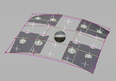

Multi Surface Patterning
This script lets you transfer a pattern of points from a planar NURBS or subdivision surface to a target surface, and then instance a selected object at those point locations on the target surface.
Follow these guidelines when selecting inputs for this script:
  • Entities to be placed - Refers to the geometry you want to instance on the target surface.
  • Pattern Single Surface - Refers to the source surface of the point pattern.
  • Pattern Points - Refers to all points in the pattern on the source surface.
  • Guide Curve and 2nd Guide Curve refer to the boundary curves on the target surface. The space between these curves defines the implicit surface on which the point pattern gets transferred and the selected geometry gets instanced.
  • Center Point, Optional - This parameter lets you select a center point of the object you want to place, such as its pivot point. If you do not select an input, the center of the object bounding box is used by default.
  • Surfaces to Pattern - Refers to the target surfaces receiving the points pattern and placed geometry.
Other parameters include the following:
  • Stretch&Squeeze - Setting this parameter to 1 turns on Cut mode, which cuts off the pattern at the point it no longer fits on the target surface. Setting this parameter to 0 turns on Stretch & Squeeze mode, which resizes the pattern so that it fits onto the target surfaces.
  • Align to surface normal - When on the geometry gets oriented along the normal of the target surface.

Subdiv Car (2024.0.48)
Creates a simple subdivision model of a full car body, half of a car body, which consists of two bridged wheel arches, or just two wheel arches. Use the script controls adjust model dimensions, wheelbase, and overall topology. You can use this script to quickly generate a base car shape for further design and refinement.

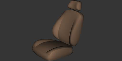

Subdiv Car Seat Generator (2024.0.5)
This script allows you to quickly generate and shape a rough version of a subdiv car seat. Select three section curves as inputs, and the script generates a complete seat. Use the parameter sliders to control the shape of the seat components. You can also define the output resolution of the subdiv geometry.
Subdiv Cone (2024.0.3)
Uses two construction points as inputs to create a subdivision cone.

Subdiv from Nurbs
Use this script to convert a NURBS object to a subdivision object. You can choose to keep the input NURBS surface after generating the subdivision object.

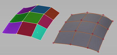

Subdiv from Planar Surfaces
Create a subdivision object from a collection of planar NURBS surfaces. You can choose to keep the original input NURBS surfaces after generating the subdivision object.
Tip: Use the Surface Edit > NURBS to Bezier tool to split your NURBS surface into separate planar surfaces before using the script.
Subdiv Loft (2024.0.3)
Creates a lofted subdivision object by using one or two guide curves, and two or more cross section curves as inputs.

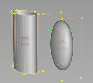

Subdiv Morph between 2 Objects
This script uses two subdivision bodies as source inputs and generates a third body which is an intermediary object of the source objects. Use the Morph Ratio to adjust the ratio of influence either subdivision source input has on the resulting shape of the third body. This script includes a WIRE file for reference purposes.
For best results, follow these guidelines:
  • The two source subdivision bodies should derive from the same model and be only slight variations of each other. Copy and paste the model to create the second source object.
  • Each source body needs to have the same number of CVs. This ensures that the script works correctly since it uses the internal IDs to determine the connecting vector between each ID matching CV pair.
  • Place the two source objects on two separate layers. When the script generates the third object, it gets put on its own layer. You can then easily hide the source objects, and then adjust the Morph Ratio parameter to the update the intermediate object.

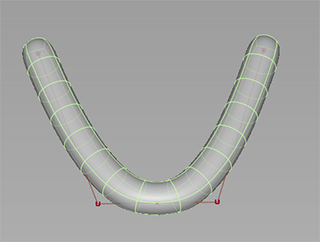

Subdiv Pipe (2024.0.2)
Uses any number of selected curves as inputs to create a subdivision pipe. At the connection point between two tangential curves, the pipe geometry merges without additional topology. You can choose whether or not to add caps to the ends of the pipe geometry.
At the connection of position continuous curves, the script adds topology to create the proper angle in the pipe.

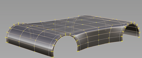

Subdiv-Wheel-Arch-2021.2.3.dyn
This script generates the curve topology for wheel arches. After loading the script, press the spacebar or click Build to generate the geometry. You do not need to provide curve inputs for the script.
  • Radius - Radius of the wheel arch to the center point.
  • Width - Width of the topology around the arches.
  • Wheel Arch Radial Spans - Number of spans along the arch.
  • Wheel Arch Across Spans - Number of spans from bottom to topic of the arch
  • Spans Front to Back - Number of spans between the front and back wheel arches.
  • Width Offset Back - Offsets the rear arch along the X axis by pushing it out.
  • Height Offset Back - Offsets the rear arch along the Z axis by moving it up or down.

Subdivision Edit
Subdiv Align
This script aligns the open edges of a subdivision objects in any direction to a reference surface. To only align the first row of CVs, set Mode to G0. To only align the second row of CVs, set Mode to G1. Set mode to G0+G1 to align both rows of CVs. By default the script aligns the CVs at G1 to the surface. When using G1 alignment, you can specify the alignment angle applied to the second row CVs. Use the G1 Angle parameter to set the alignment angle between -180 to 180 degrees.
Note: This script replaces the DP-Subdiv-Perpendicular-Align.dyn script from the previous version of Alias.
Use this script with the DP-Rim-Support-and-Radial-Scaling.dyn script to accurately align your spoke geometry to the rim reference geometry. To work correctly, the subdivision objects must have open edges, such a subdivision cylinder without a cap.
Subdiv Morph by Curve (2024.0.12)
Modifies an input subdivision object, or optionally, a subset of its CVs. The modification is based on the difference between a selected reference curve and a modified version of the curve.
Subdiv Morph by Surface (2024.0.8)
Modifies an input subdivision object, or optionally, a subset of its CVs. The modification is based on the difference between a selected reference surface and a modified version of the reference.

Shrink Wrap (2024.0.1)
This script lets you project a subdivision object onto other objects, such as other subdivision objects or NURBS surfaces.
