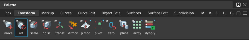

and turn on Local Axes Display.Access this tool from the Transform palette:

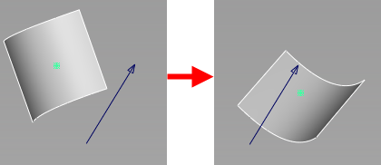

Rotate objects around a vector, which you create by clicking in the view where you want the vector to start or typing the start position in the promptline, adjusting the manipulator to position the vector, and then clicking Accept.

Rotate around a vector
Select the tool.
Create the vector by clicking in the view where you want the vector to start or typing the start position in the promptline.
Adjust the manipulator to position the vector and click Accept.
Enter a sweep angle on the promptline.
