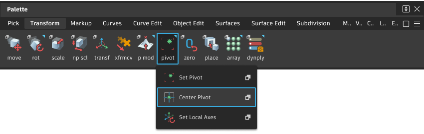

Automatically positions the pivot point at the center of the picked object.
Access this tool from the Transform tool palette:

Center Pivot workflow
Set the pivot to the centroid of an object:
- Pick the object.
- Select the Center Pivot tool.
