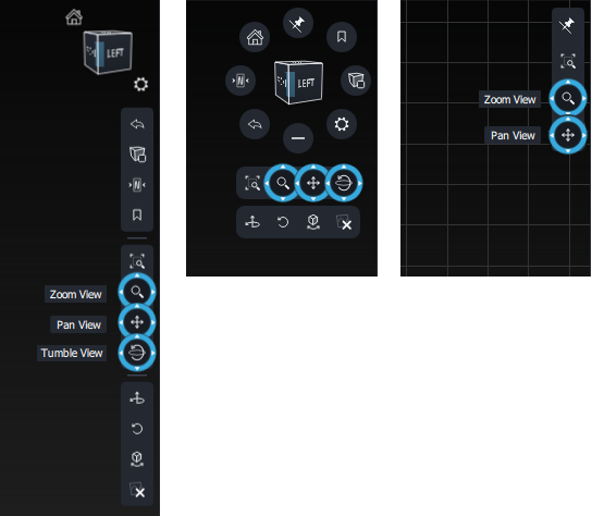

There are three ways to tumble, pan and zoom the view:
- Holding the
Shift+Altkeys while using the mouse buttons - Click-drag on the ViewCube (tumble only, in the perspective view)
- Navigation bar icons

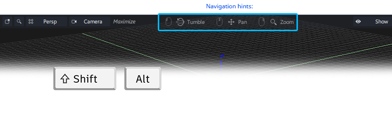

When Shift + Alt are engaged, a hint will appear at the top of the view window explaining each mouse button drag function:

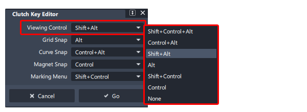

Changing the Clutch Keys for viewing
The default viewing keys can be changed from Shift + Alt using the Preferences > Clutch Keys Editor

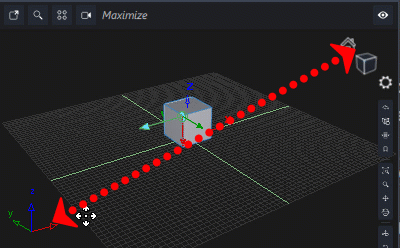

The ViewCube is typically shown on the top right corner of a persepctive view and can be used to manipulate the view.
Move the cursor over the ViewCube, and click-drag the mouse to tumble the view.
See ViewCube tools for more information on working with the ViewCube.
