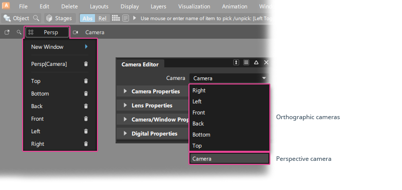

Use the drop-down menu to select a camera to display its properties in the Camera Editor.
A single scene may contain several cameras. For example, by default a scene contains four cameras corresponding to the four modeling windows: top, front, right, and perspective (camera).
Orthographic cameras have limited settings in the Camera Editor, and they can't be viewed or manipulated as an object in the modeling windows.
Perspective cameras are used to create the view in a perspective window. They are also objects, but by default, they are not displayed in the scene.

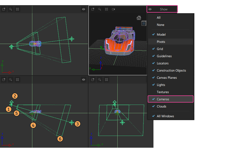

Use Show > Cameras on the viewport window title bar to display a perspective camera in view windows other than the one created by that camera.
Perspective cameras have the following elements:
- Eye - the camera's position
- Up - the up vector end point
- View - view point or focal point
- Focal Distance
- Near Clipping Plane
- Far Clipping Plane

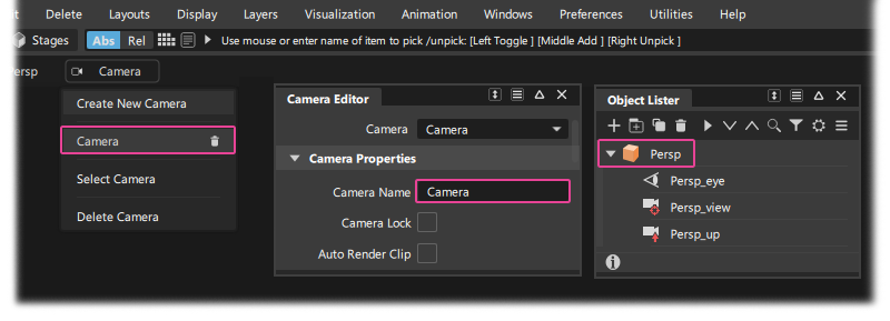

Camera Name
Type in this field to change the name of the camera as displayed in the view windows title bar menus. The name defaults to 'Camera' or 'Camera#1, 2, 3' etc.

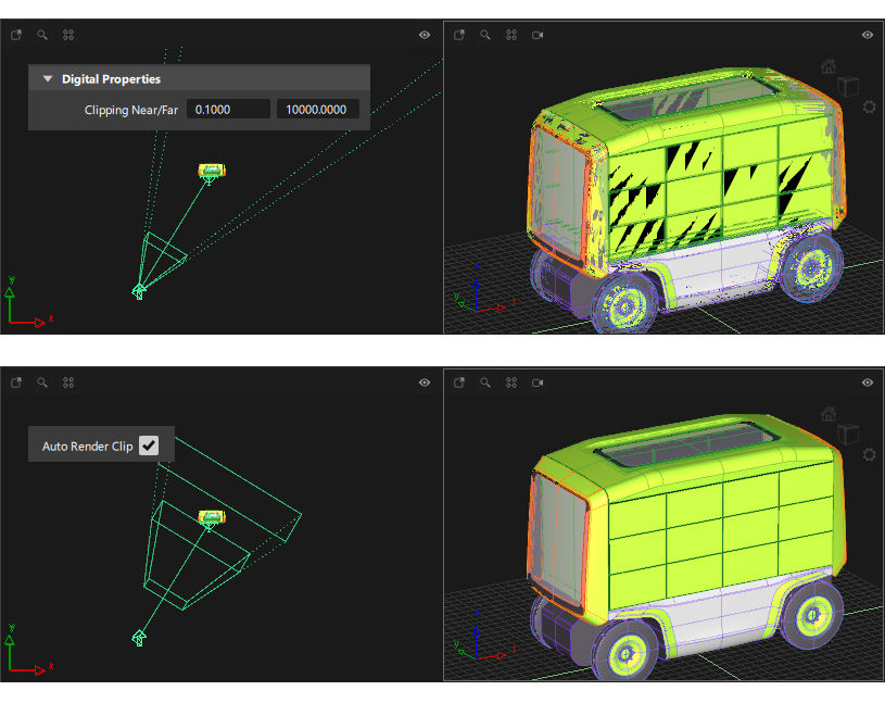

Auto Render Clip
The near and far clipping planes are set based on the bounding boxes of the objects in your scene so that they include all visible objects in the current view frame.
The distance between near and far clipping plane defines the accuracy of the depth buffer. That means a very large distance leads to incorrect depth buffer behavior - so for example you might see curves that should be hidden by a surface..
By turning on Auto Render Clip, you can prevent these image quality problems:
Turning on Auto Render Clip disables the display of the clipping plane near and far values in the Digital Properties section below. When you turn off Auto Render Clip, the manual settings update and can be adjusted if needed. For example, the Auto Render Clip settings may be too close to the surfaces and obscure CV display for example. So, you may want to increase the space around the objects.

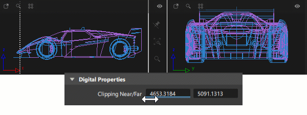

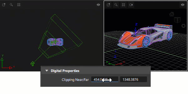

Clipping Near/Far
The distance to the camera's near and far clipping planes. The default values are 0.1 and 200.
For perspective cameras, the Clipping Near/Far values are distances from the camera.
For orthographic windows, the Clipping Near/Far values are distances along the axis that points into the screen. For example, if the Back window shows the YZ plane, then the Clipping Near/Far values are distances along the X axis.
You cannot enter a Clipping Near/Far value less than 0.1 within Alias.
Make sure the Clipping Near/Far values are set so that the clipping planes comfortably contain the contents in your scene. Setting the Clipping Near value very low or the Clipping Far value very high may produce image quality problems during visualization.
