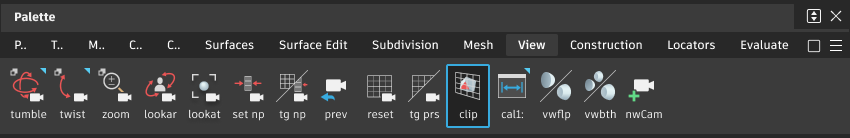

Access this tool from the View palette:

From the Tool Palette, select View > Adjust Clipping Plane or click its icon.
