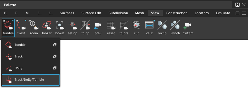

Track/Dolly/Tumble
Tracks, dollies, and tumbles with the use of different mouse buttons. We recommend that you use the ViewCube instead of this tool.
Access this tool from the View palette:
Tracking, dollying, and tumbling workflow
After selecting the tool, you can use modifier keys with the mouse. The following list shows the modifier keys and related actions.
Note: Avoid clicking any objects or you will change the point of interest of the camera. If you do not want to do so, it might be easier to select a point of interest instead.
