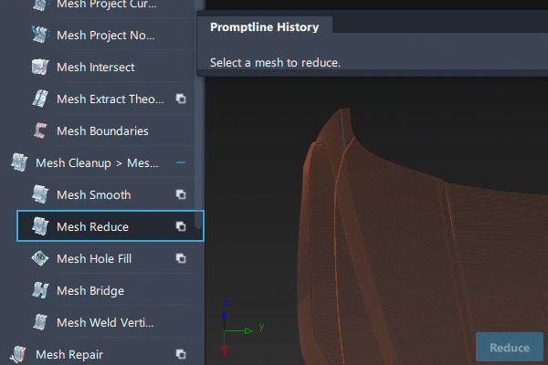

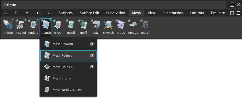

Access this tool from the Mesh tool palette:

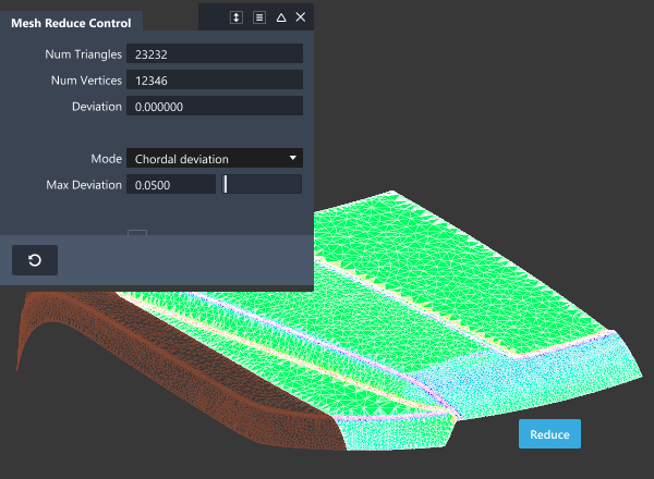

Reduce a mesh based on chordal deviation
Shift-select the Mesh Cleanup tool icon:
.In the option window, set Mode to Chordal Deviation.
Adjust the Max. Deviation slider to the maximum deviation allowed from the original mesh.
Select the mesh to reduce.
The option window displays the current number of triangles and vertices.
Click the Reduce button (in the lower right corner of the window).

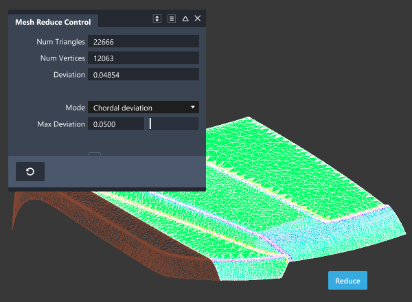

Triangles are deleted in the mesh and the option window shows the number of triangles and vertices remaining, as well as the maximum deviation from the original mesh.
To see a color deviation map showing the deviation between the original and reduced mesh, turn on Show Deviation Map and adjust the Deviation Map Settings if necessary.
The color map display updates each time you click the Reduce button.

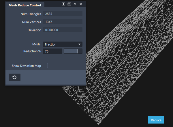

Reduce a mesh by a given percentage (fraction)
..In the option window, set Mode to Fraction.
Adjust the Reduction % slider to reflect the percentage of triangles you want to keep in the mesh.
Click the Reduce button.
You can click the Reduce button again to keep reducing the number of triangles in the mesh.
After reducing the mesh three times, the number to triangles goes from 2535 to 975.
