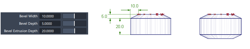

Bevel Width, Bevel Depth, Bevel Extrusion Depth
Enter initial values for the bevel parameters in the option window.
These can be changed interactively after the first Go (when the proxy surfaces are displayed) using the following:
  • Drag the to change the bevel width.
  • Drag the to change the bevel depth.
  • Drag the to change the extrusion depth.
Note: Use a negative bevel depth to reverse the bevel. Use a negative extrusion depth to reverse the direction of the extrusion.

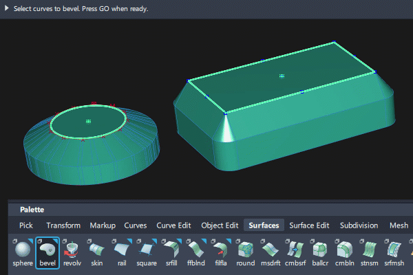

Bevel workflow
The bevel tool creates a group of surfaces:
To create a bevelled edge:
  1. Either :
    • Pick the curves or surface edges first, then select the Bevel tool .
    • Or select the Bevel tool first and follow the prompt - pick the curves or surface edges.
  2. Click on the Go button (or use space bar as a short cut).
  3. Do any of the following:
    • Type the bevel width, bevel depth, and extrusion depth separated by spaces to set the values exactly.
    • Or none of these, and the settings in the tool option window will apply.
  4. Click Go to create the surface or use the space bar as a short cut.
