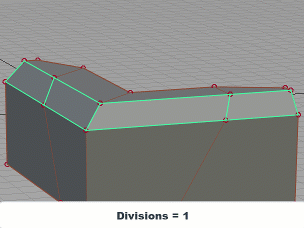

Divisions
Specifies the number of faces to insert between the new edges. A Division value of 1 adds two new edges equally spaced to either side. A value of 2 keeps the original edge between two newly created edges on either side.
You can set this value using the slider, MMB dragging on your model in the viewport, or by input into the promptline.
Divisions: 1 to 8

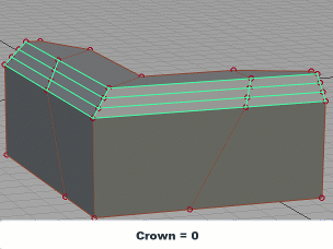

Crown
Creates a rounded crown using the new faces. You need 2 or more Divisions to create a crown. Adjusting this value sets the height of the crown.
A value of 1.0 sets the crown to its the maximum height, which generates a rounded edge. A value of 0 does not create a crown, resulting in a flat beveled edge. By default Crown is set to 1.0.
You can set this value using the slider, RMB dragging on your model in the viewport, or by input into the promptline.
Crown: 0 to 1.0

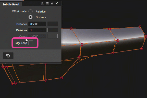

Edge Loop
Check this box to select an edge loop when you pick an edge.

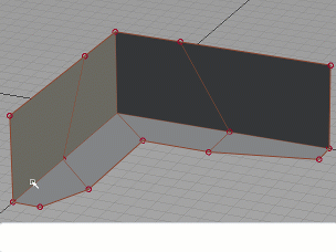

- Shift-select the tool.
- Pick the edge or edge loop you want to bevel.

Note: By default, the bevel edge is rounded when you add two of more faces by setting Divisions to 2 or higher. To flatten the beveled area, set Crown to 0.Adjust the shape of the beveled edge by adding or removing curvature using the Crown slider.
