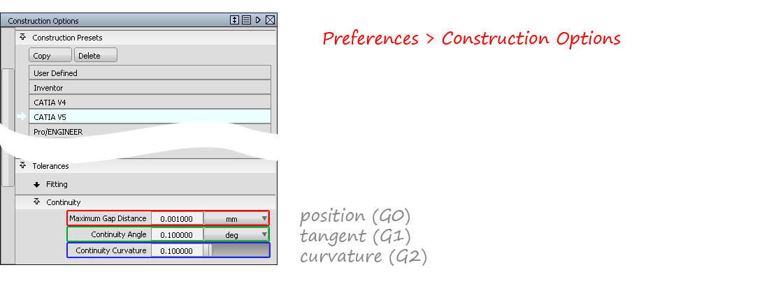

Baseline Requirements: G0, G1, G2
The baseline requirements for Class-A are the same as for production-quality surfacing in all industries: to build to tight tolerances for G0, G1 and G2 continuity.
In Alias this is achieved by using the right Construction Tolerances before you start modeling, for example 'Catia V5'.
And by checking that these have been achieved using one or more of the following tools:
- Surface Edit > Stitch (to check the whole model for G0 gaps)
- Evaluation > Surface Continuity ( to check individual boundaries for G0, G1, G2)
- Evaluation > Model Check (to check the whole model for G0, G1, G2, and duplicates, small edges etc.)
It's important to note that there are no absolute rules for tolerances or continuity levels. It is part of the skill and knowledge of the Class A modeler to be able to judge which settings will result in the right quality in the production car.

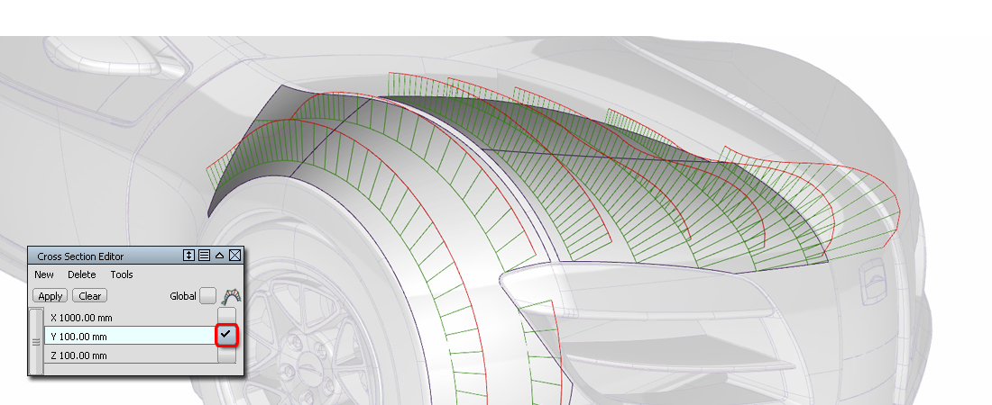

Evaluating Highlights
'Perfect Highlights' can't be judged by a single evaluation, instead a combination of methods is used:
- Continuity at Boundaries: Evaluation > Surface Continuity
- Continuity across boundaries: Locators > Curve Curvature and Windows > Cross-Section Editor
- Continuity Flow: Diagnostic Shading > Iso-Angle and Diagnostic Shading > Light Tunnel
- Highlight Flow: Diagnostic Shading > Saddle Lines
- Surface Quality: Diagnostic Shading > Curvature Evaluation

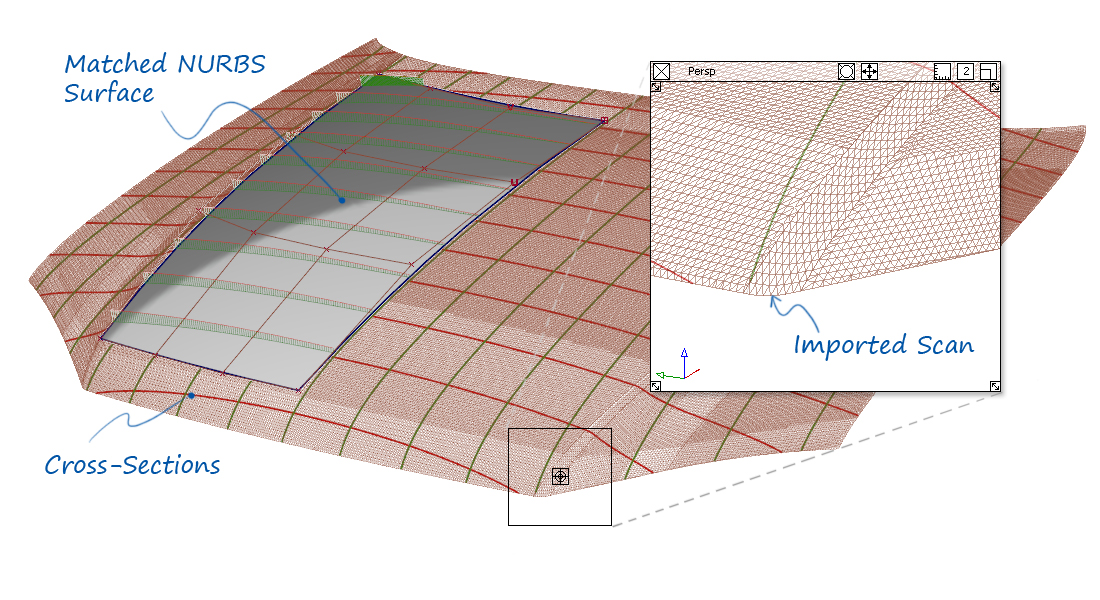

Reverse Engineering
Reverse Engineering is the process where a physical model (typically a clay) is scanned, and then rebuilt as a NURBS model.
The modeler will be given a tolerance by which the NURBS data must match the scan. However, scan data will always have some imperfection, or 'noise', and there also may be imperfections in the clay model.
So the skill of the Reverse Engineer is to maintain the exact design character of the scan, whilst rejecting unintended imperfections.
