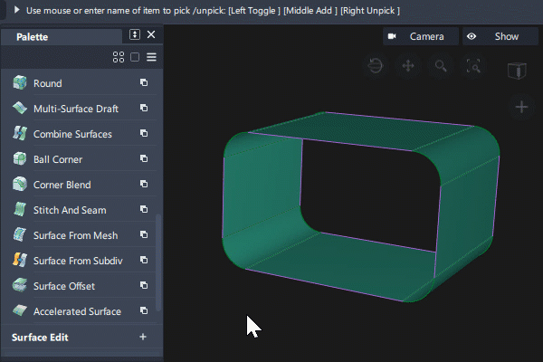

Creates an offset surface with the specified distance from the original surface. For each selected surface composite, a vector handle is displayed in the graphics area to control offset distance and direction.
Access this tool from the Surfaces palette:

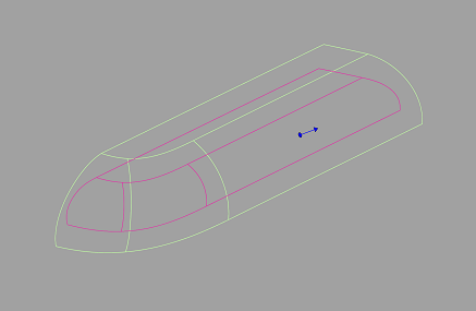

  1. Shift-select the Surface Offset tool icon.
  2. Pick the surface you want to offset. The offset appears in a different color than the picked surface with an arrow indicating the direction of the offset. The image below displays offsets of multiple surfaces.
  3. Do any of the following:
    • Drag the arrow left and right to change the offset distance. You can also change the offset direction by dragging the arrow head or clicking the base of the arrow.
    • In the Surface Offset Control window, type a number or use the slider to set the Offset Distance exactly and specify other options for the offset. You can specify a positive or negative Offset Distance value to create a curve offset on either side of the original curve.
    • Select additional surfaces (or de-select them) by holding the Shift key while clicking them or using a pick box.
