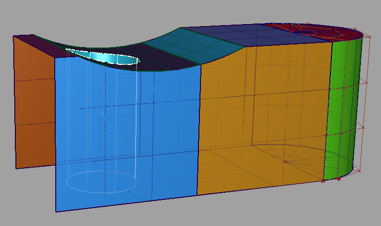

Lets you see and pick different types of objects through shaded geometry without making the geometry transparent. This lets you more easily manipulate your model while visualizing it with Hardware Shade or Diagnostic Shading.
Obscured geometry is drawn partially transparent to show that it is on the back side or inside the shaded objects.
Xray Options
Controls
When on, CVs, edit points, and blend points are visible through shaded geometry.
Hulls
When on, hulls are visible through shaded geometry.
Model
When on, the model wireframe is visible through shaded geometry.
Locators
When on, locators are visible through shaded geometry.
Pivots
When on, pivot points are visible through shaded geometry.
KeyPoints
When on, keypoints are visible through shaded geometry. (Keypoints appear on geometry created from tools in the Curves > Keypoint Curve Toolbox.)
Visibility
Controls the level of transparency of the shaded geometry. A value of 1.0 means completely transparent, and a value of 0.01 means virtually opaque. The default is 0.15.
