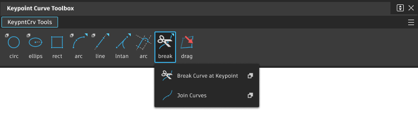

Access these tools from the Keypoint Curve Toolbox:

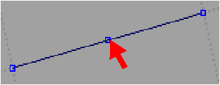

Break Curve at Keypoint
Splits a curve at a keypoint. Select the tool, and then click a keypoint on a curve.

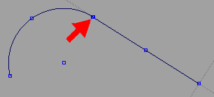

Join Curves
To join two curves at their endpoints, make sure that their endpoints overlap (are coincident), then choose the tool and click the overlapping keypoint or edit point.
Note: You can also join regular curves by clicking on the overlapping edit points at the end of the curves.
