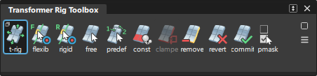

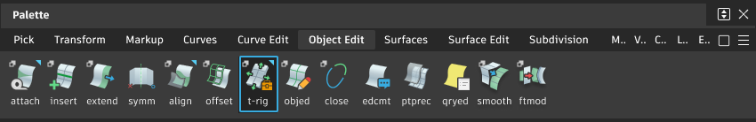

Access the Transform Rig from the Object Edit tool palette:
Transformer Rig toolbox
Selecting the Transformer Rig icon
Transformer Rig opens the toolbox:
Transformer Rig
This tool is the first tool to choose when adding a rig to a model. It enables you to choose what to modify. See Transformer Rig general workflow for information about how to create a rig.
Double-click or ! Shift-click this icon to open the option window. You can only open the window after a target has been chosen. Use the settings in the window to:

Add Flexible Targets

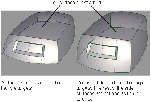

Add Rigid Targets
Rigid targets are surfaces, meshes, or curves. They transform (translate and/or rotate) along with the modification, but keep their shape; that is, the targets do not scale or shear.
To add rigid targets, click the icon and select the geometry, then click Accept Targets. To remove targets, choose the Remove from Rig tool in the toolbox.
Use the
on a target to open a pop-up menu that enables you to lock the movement direction for the rigid targets.
If Rigid is selected, the target is free to rotate and translate in all directions. Rigid Translate only allows translation to occur: the target is not rotated. Further restrictions can be used with the X, Y, and Z constraints, which allow translation to occur in only one specific world-space axis direction (note: this does not respect construction planes). You can also change the type of target from Rigid to Flexible, or vice-versa.
Add Free Modifiers

Add Predefined Modifiers

Add Constraints

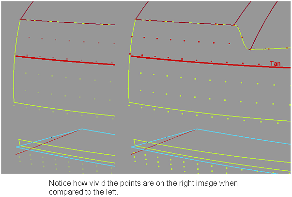

Add Clampers
Clampers can help the software recognize regions of the model that should not be modified. These regions are usually defined by the constraints, but in some cases, the help of a clamper or clampers is needed. These regions can be identified with the help of the green and red dots that appear when setting constraints. These dots appear when Clamp Visualization is checked in the option box.
The region with green points is the region that is free to be modified. The region with red points is fixed, and will not change. To improve the visualization temporarily, pick a dot with the middle mouse button to make the colors more vivid.
Remove from Rig

Revert

Commit

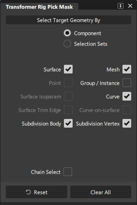

Show Pick Mask
This tool helps when selecting items for use in the rig, because you cannot use the Pick Components tool inside the Transformer Rig. Notice that the edge of a trimmed surface is not a surface isoparm, it is a surface trim edge.
Click the check boxes to set an entity type.

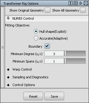

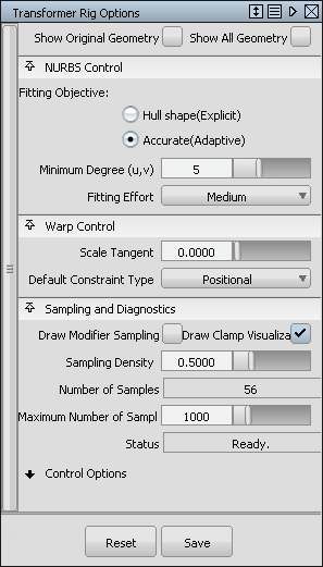

Transformer Rig Options
To see the Options window while in the tool (you must have some geometry already accepted as a target), hold the Shift key and click the Transformer Rig tool icon in the toolbox, or double-click the tool icon.
To see the Options window while outside the tool, first re-enter the tool by selecting Query Edit
then select an object that has dynamic shape modeling history. Hold the Shift key and click the Transformer Rig tool icon in the toolbox.
Show Original Geometry
If checked, this box enables the display of geometry as it was before the Transformer Rig tool was applied. If unchecked, the current version of modified geometry is displayed. Use this feature to flip and compare “before” and “after” geometry.
Show All Geometry
If checked, this box enables the display of both the original and deformed geometry.
NURBS Control
The fields in this section control the way the Transformer Rig tool modifies NURBS target surfaces. Settings in this window have no effect on meshes that were selected as targets. If all targets are meshes, or if Mesh Output is set, this section of the control window is hidden.
Fitting Objective
The available methods are:

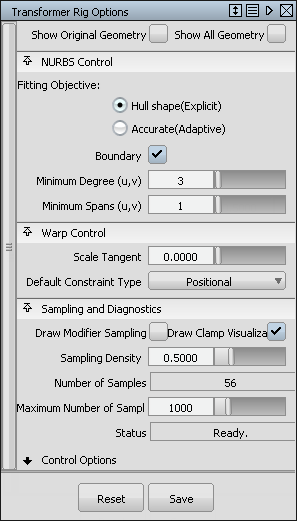

Hull Shape (Explicit) – Optimizes fitting for hull shape. This option allows for explicit control of minimum degree and spans. If the boundary field is checked, the fitting is optimized for patch boundaries.
Accurate (Adaptive) – Optimizes fitting for accuracy. This determines the minimum number of spans necessary for an accurate representation of the modified shape.
The Fitting Effort option has been reorganized to a pull-down menu with Low, Medium, High, and Custom values. If Custom is selected, a slider can be used to set the value precisely.
Minimum Degree (u,v)
Specifies the minimum degree of resulting patches. If a patch target has degree less than the specified degree, its degree is raised to the specified degree. This has the result of making the math heavier, but in general the results of the shape modification are more accurate.
Minimum Spans (u,v)
Specifies the minimum number of spans in the U and V directions. If necessary, existing spans are subdivided. This has the result of making the math heavier, but in general the results of the shape deformation are more accurate.
Fitting Effort
While it is not possible to give a true tolerance for gap continuity, the fitting effort is a number that points to the gap quality. The larger the number, the tighter the gap is between surfaces, and the longer a modification takes to execute. To influence the final maximum gap distance after the modification, increase or decrease the fitting effort. The Transformer Rig inserts more spans to achieve tighter gaps between surfaces, up to the maximum set in Max Surf Spans in Construction options.
The Fitting Effort option has a pull-down menu with Low, Medium, High, and Custom values. If Custom is selected, a slider can be used to set the value precisely.

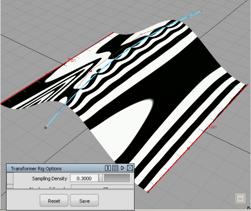

Sampling and Diagnostics
The overall intent of the controls in this section is to help control the quality and performance of Transformer Rig modifications.
Some error conditions stop the deformation from proceeding. When a deformation cannot be applied, the outlines of target geometry are drawn with dotted lines.
Stress Exceeds Threshold: This error condition is triggered if there is too much stress in the shape modification, typically due to conflicting modifiers and constraints simultaneously forcing the surface to move and stay put. Red arrows point to the samples with too much stress. You can correct the condition by rearranging modifiers and constraints so that they do not conflict.
Too many samples. This error condition is triggered when the Sampling Density creates too many sample points. Sample points can be viewed by turning on the Draw Modifier Sampling check box. To correct the error, either increase the Maximum Number of Samples field, or reduce the number of samples by decreasing the Sampling Density field or eliminating unnecessary modifiers and constraints.

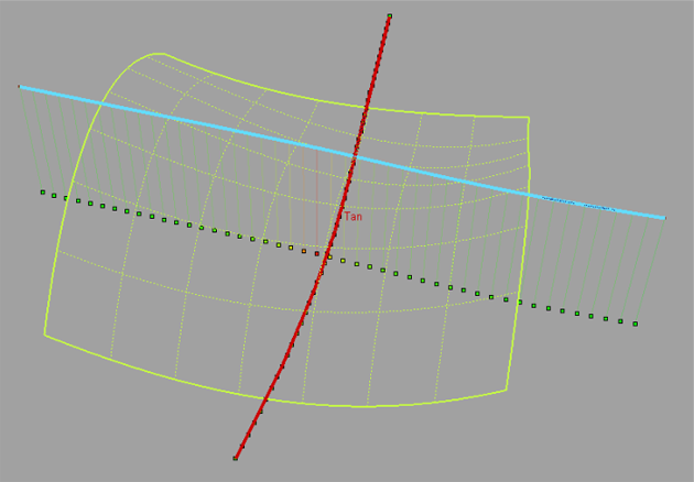

If this box is checked, this value enables you to visualize the sampling of the modifiers and constraints.

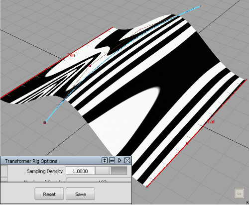

Sampling Density
Determines the number of samples on the modifier and constraint geometry. These sample points guide the shape modeling process. As the number of sample points increases, so does the accuracy of the warp — the time it takes to perform the modification also increases.

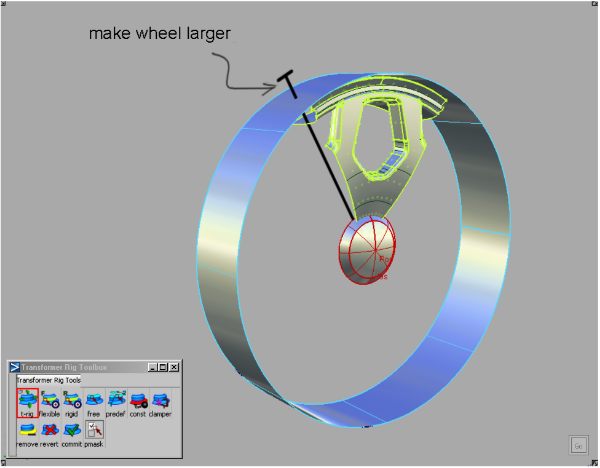

Open the Transformer Rig Toolbox by clicking the Transformer Rig tool icon
in the Object Edit palette.The Transformer Rig Toolbox opens.
Select the target geometry, then click Accept Targets.
Choose either the Add Free Modifiers or Add Predefined Modifiers tool. Select the modifier geometry, then click Accept Modifiers.
For further information about adding modifiers, see the individual tool descriptions.
Optionally
Select constraints
Select clampers if the clamp visualization still shows problems. For more information, see Add clampers.
Click Go in the lower right corner of the screen. Leave the tool by choosing a continuous tool.
Now you can modify the targets using common Alias tools like transform or transform CV on the modifier geometry.
When you have finished modifying the geometry, Commit to the modification, or Revert to start over. For more information, see Commit and Revert.
Note: Diagnostic shading is lost for deformed objects with the transformer rig. When using the transformer rig tools, any objects you request to be deformed lose their diagnostic shading. The software creates new surfaces for these objects. Whenever a tool creates new surfaces, these surfaces do not display diagnostic shading. Click diagnostic shading in the Control Panel to reapply it to the objects.
The geometry tagged as targets in the rig now shows up in dark green, which shows it has construction history. To modify the rig (such as adding or removing modifier geometry, targets, and constraints), query edit any target geometry to re-enter the tool.
If the transformer rig setup has any problems, the output geometry is shown with dashed lines to indicate that it has errors that must be corrected. For tips on how to correct problems, see Trouble Shooting.

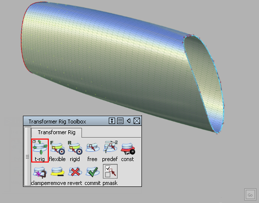

Click the Transformer Rig icon to open the Transformer Rig toolbox.
First, the Transformer Rig expects you to specify the initial set of target geometry.
Pick all the geometry that should be modified, and ensure that geometry that shouldn’t change is not included.
When you're satisfied with your selection, click Accept Targets.
Remember: you can always add to or remove from the target geometry set later.
Next, you are prompted to add modifiers. In a Transformer Rig, there must be at least one modifier geometry.
Click the modifier icon (either Add Free Modifiers or Add Predefined Modifiers) that suits your needs.
Select the geometry that will serve as a modifier.
Click Accept Modifiers when you are satisfied with your selection of modifier geometry.
Next, add geometry that will constrain the changes to the model. Click the Add Constraints icon.
At this point, you may want to edit the pick mask before selecting curves to use as constraints.
Instead of using the Marking Menu, click on the Show Pick Mask icon to open the Transformer Rig Pick Mask: Add Target Mode window to modify the pick mask.
You may want to turn off options for entity types that you don’t want to accidentally pick.
Close the window.
Click or click-drag to select the constraint geometry.
Click Accept Constraints when you are satisfied with your selection.
To finish, click Go.

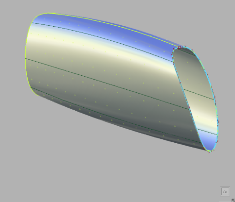

To use the Transformer Rig, you leave the Transformer Rig toolbox and change the shape of the model by manipulating the rig with the standard Alias transform tools.
Leave the Transformer Rig toolbox by choosing Pick > Object.
The color highlights disappear when you leave the tool. Also notice that the geometry selected as targets now has history.
Pick the modifier geometry.
Use one of the Transform tools (Move, Scale, Rotate, Non-p scale) on the modifier geometry to achieve the desired shape.
Through Transformer Rig history, the target geometry updates automatically when you change the modifier geometry. You can also change modifier control vertices, and attributes such as degree and number of spans.

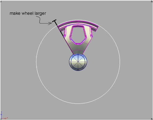

Use rigid targets with Transformer Rigs
Rigid targets are free to translate and/or rotate according to the modifications you have made. However, they are not to change shape at all: hence the name "rigid".
Click the Transformer Rig icon to open the toolbox.
Click the Transformer Rig tool. You are prompted to select geometry.
Pick the surfaces to be modified.
Click Accept Targets. The selected surfaces become flexible targets.
You are prompted to add modifiers.
Choose the tool (either Free or Predefined) and select the geometry to serve as modifiers, then click Accept Modifiers.
You are prompted to add Flexible or Rigid targets.
Click the Add Rigid Targets icon.
Pick the surfaces that should change position or orientation, but not change shape.
Click Accept Targets after selecting appropriate surfaces.
The rigid targets are now highlighted green, with the word Rigid on top of them. You can modify the attributes of the target by clicking it with the
to open this menu:
This menu enables you to switch a target from rigid to flexible, and vice-versa. You can also prevent rotation of the target by choosing Rigid Translate, or constrain it further by choosing one translation axis.
Now add Constraints if they are required. Click the AddConstraints icon.
Pick the appropriate geometry.
Click Accept Constraints to add the geometry as constraints.
Click Go to finish
Select the target geometry.
Click Accept.

The Transformer Rig provides visual feedback about what is outside the region of modification. Red dots show regions that are clamped (will not change), while pale yellow dots show regions that are free to move.
The Transformer Rig uses the modifiers and constraints to make an educated guess at what is outside the region of modification, but sometimes it needs help to determine this correctly.
To provide the Transformer Rig with a hint that a particular part of the surface is to be held fast, add a clamp point. Clamp points can only be added if there are targets and constraints already applied to the Rig.
Choose the Add Clampers tool to start.
Click on the edge of the surface that should not be modified by the Transformer Rig.
A pink indicator appears where you click to show that a clamp point has been established.
If you are clamping an area that has inadvertently moved, you will see that it snaps back to its original, and proper, position.
The visualization also updates to show that the Transformer Rig has understood to hold fast the selected area of surface.
Add more clamp points, if required, by repeating the process.

Try the options in the current selected Fitting Method.
- increasing the values in the options tends to give you a more accurate result which takes longer to compute
Try the other Fitting Method.
Each case is different — it all depends on the geometry and the intent. As you gain experience using the tool, you will develop a better feel for which method works best.
Draw Correspondence gives visual feedback as to whether there are conflicts in the rig, as a result of interfering modifiers and constraints. The visualization is green where there is no conflict, and graduates from green to yellow to red to show regions of conflict. This is a good diagnostic tool when the shape modification behaves wildly.
In the following image, the modifier and the constraint intersect. Notice that close to the intersection point, the visualization turns from green to yellow to red, to indicate that there is a conflict.
The Sampling Density field controls quality and speed. A low value results in faster updates, but may introduce quality problems. A higher value results in a more faithful shape modification, but increases the update time. The following images show how artifacts are introduced when sampling is too low, and how they can be avoided with a higher sampling rate.
Several factors may contribute to undesirable shape artifacts. They have been discussed above, and may include inappropriate NURBS fitting, low sampling density, and conflicts between constraints,modifiers, and clampers. To rule out inappropriate NURBS fitting, try toggling Mesh Output and seeing whether artifacts are affected. To rule out sampling density, try a higher sampling density setting.

Fitting Method set to Explicit (in the option window).
If working with a large file with many surfaces, Adaptive Fitting Method requires tighter calculations and will slow down the rigging process (which may not be necessary at this point).

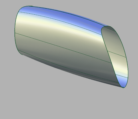

If you want to use a trimmed boundary edge or a surface boundary for a modifier (free or predefined), first duplicate the boundaries and use the duplicates instead.
In this example, we want to stretch this shape by dragging the trimmed boundary.

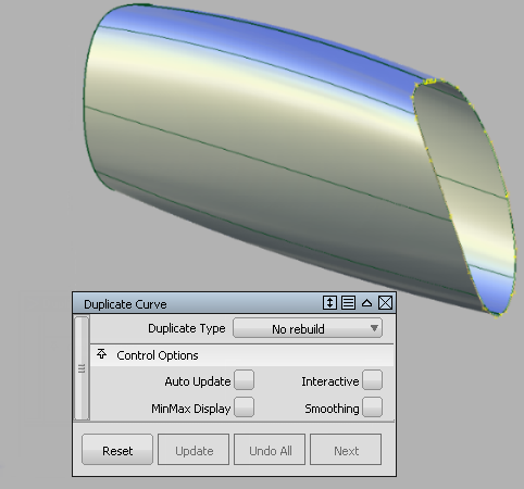

First, using Duplicate Curve, we make a copy of the trim boundary.
Assign the duplicated curve as the Free Modifier.
Pull the duplicated curve to stretch the shape.

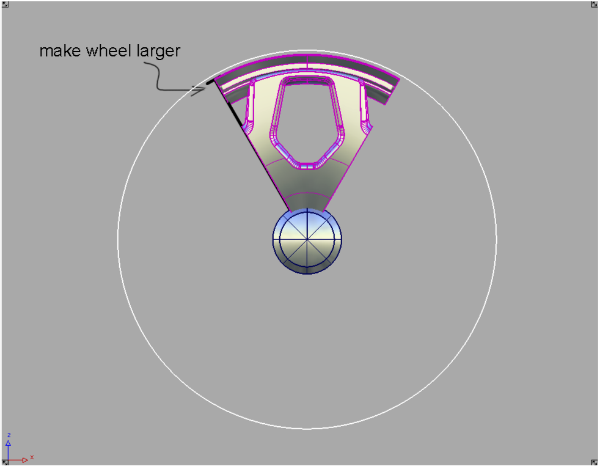

Sometimes transformations need to preserve an overall form: for example, circular shapes and planar elements.
Examples of these are wheel deformations (where radial symmetry must be preserved) and wheel well deformation (where planarity of the well must be kept).
The general principle is that, in these cases, modifiers have to be overbuilt. For example, for wheel spoke deformations, the deformer should be a cylinder, not just an arc.
For a wheel well deformation, the modifier should be a plane that is considerably larger than the wheel well.
The modifier should also be close to the target surface.
