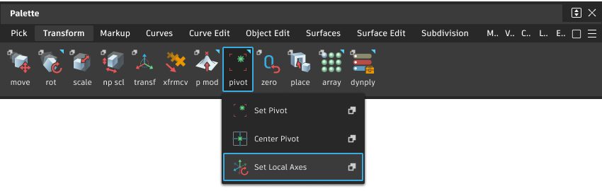

Set Local Axes
Rotates the local axes of the picked object.
Access this tool from the Transform tool palette:
Set Local Axes Options
