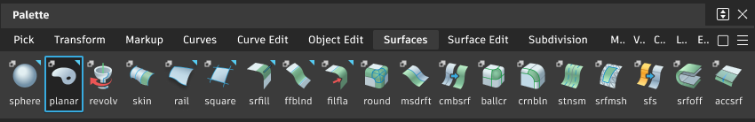

Access this tool from the Surfaces palette:

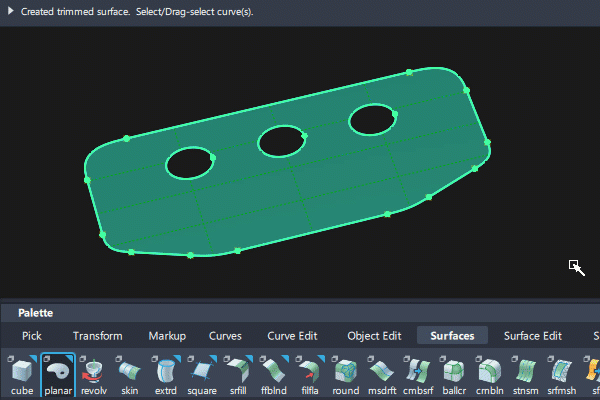

  1. Select the Set Planar tool .
  2. Pick individual curves, or drag a pick box around all the curves that define the planar surface or surfaces.
  3. Check that all curves are picked, and click Go.
A degree 1, flat surface is created and trimmed to the outside boundary of the selected curves.

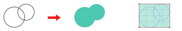

  • Curves that cross other curves are added together.

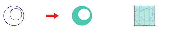

  • Curves that are completely enclosed by other curves become holes.

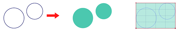

  • Curves may be separate from each other. This will create the appearance of separate surfaces but will be one single surface trimmed to each region.
