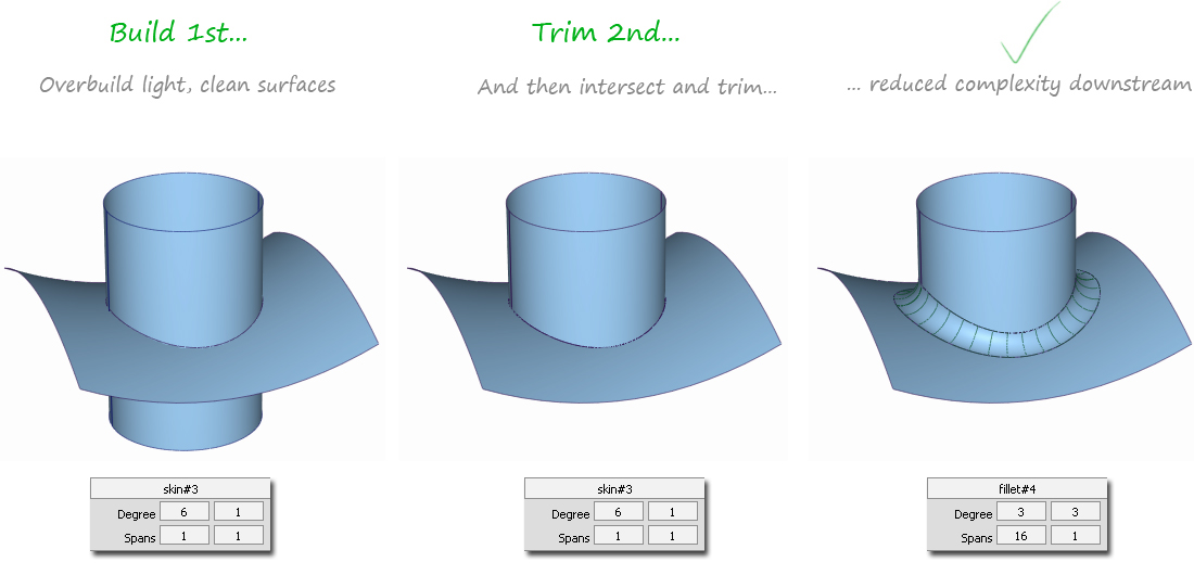

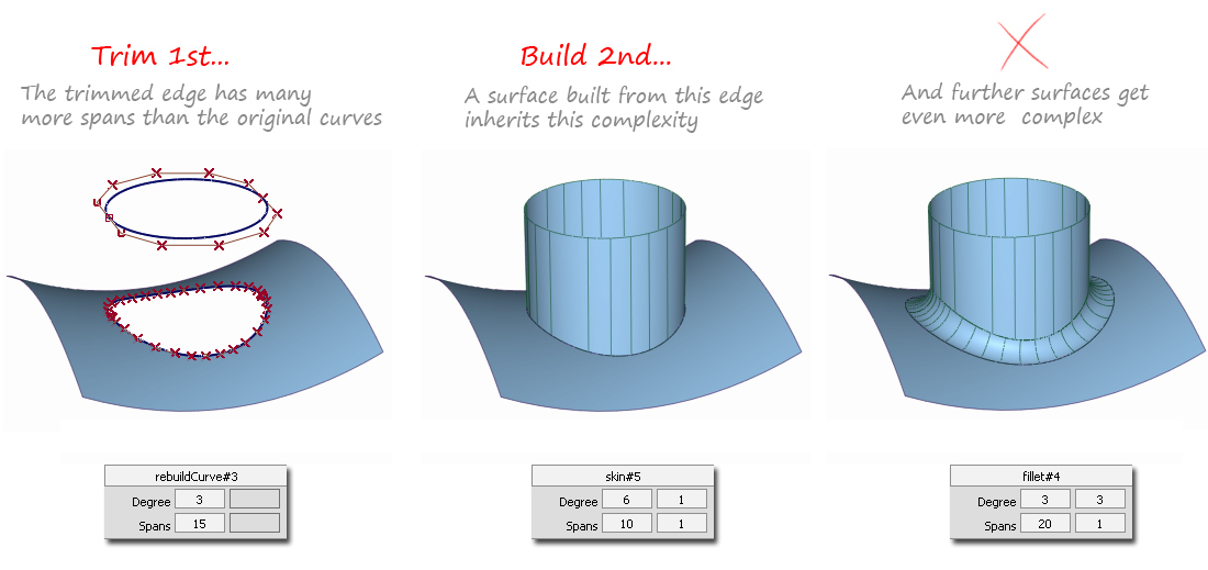

Alias Golden Rule 9: Avoid building from trimmed edges
When the design allows, 'overbuild' the surfaces first, and then intersect and trim to achieve the final design:
This is because trimmed edges will typically have more CVs than 'natural' surface edges, so avoid building surfaces from them where possible:

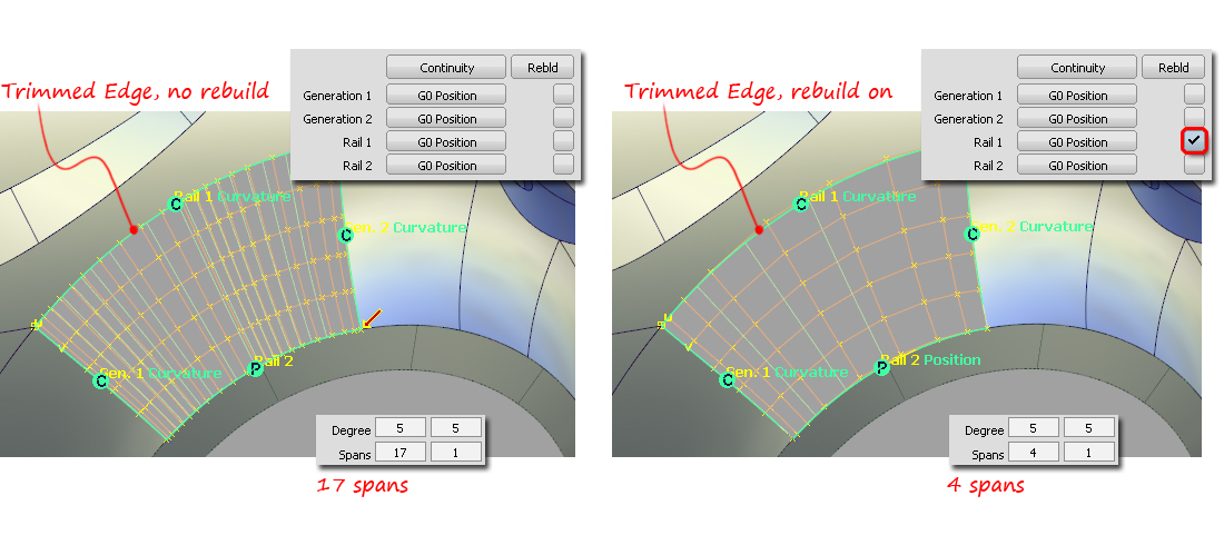

Using the Rebuild Options
When overbuilding isn't a practical option, some tools offer a rebuild option that will improve the quality of the surface derived from the trimmed edge:
Surfaces > Rail
Surfaces > Square

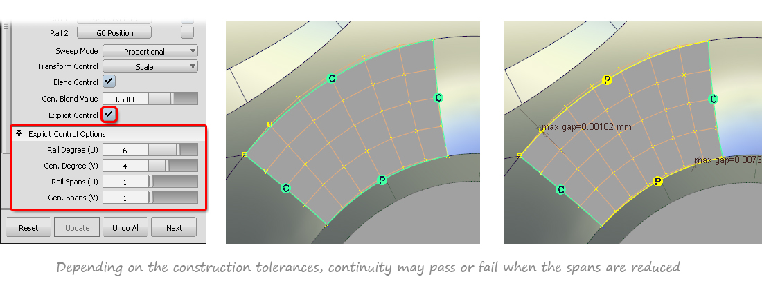

Using the Explicit Control
Another option is to use the Explicit Control Options to override the automatic parameterization of the Square or Rail tool. However, often the continuity won't be matched, so you need to use with care.

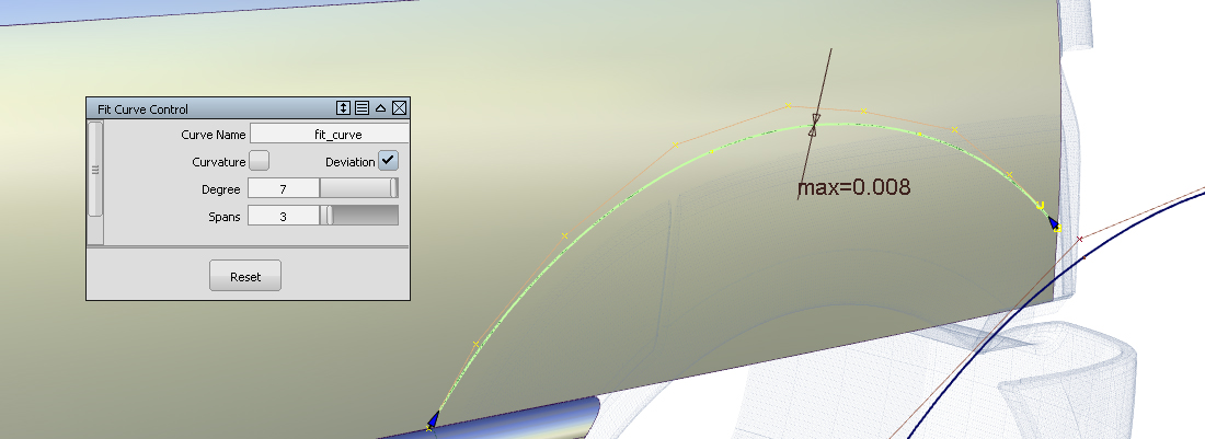

Rebuilding the edge with an accurate curve
This is an advanced technique, and limited because you can only achieve G0 positional continuity to a curve. (Higher continuity has to be achieved by manually sculpting CVs).
Tools that achieve this:
Curve Edit > Fit Curve
Surface Edit > Create Curves-on-Surface > Project (Create Curves option)
