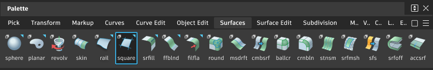

Access the tool from the Surfaces tool palette:

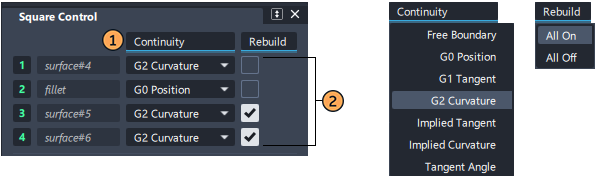

Continuity table and rebuild
The Continuity table displays one row for each boundary. Use this to select the continuity and rebuild settings:
Use the title pop-up menus to adjust the settings for all 4 boundaries.
Use the pop-up menu and checkbox on each boundary to adjust individually.
Continuity
Select the Continuity you want for each boundary. See Surface Tool Common Parameters for explanations of each continuity option.

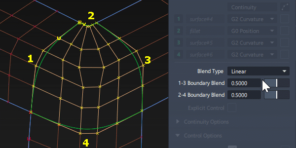

Blend Type
Linear/Cubic
Blending gives you influence over the interior of the square surface. The boundaries are constrained by the input curves and edges.
Use the sliders to nudge the surface towards one boundary shape or the other.
1-3/2-4 Boundary Blend
These sliders control the point of equal influence of opposite boundaries (in other words, the midpoint of the blend between opposite boundaries): that is, between 1 and 3, and between 2 and 4. Values can effectively range from 0.17 to 0.83.

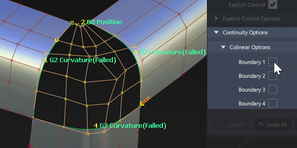

Colinear Options
Boundary 1, 2, 3, 4
When an input boundary has a flow of Hulls and CVs that you want the new square surface to match, use the colinear option. Only applies when G1 Tangent or G2 Curvature continuity is selected for that edge.
Be careful not to use colinear on edges where the CV flow would distort the square surface being built (some trimmed edges for example).
Also be careful not to leave the settings on when moving onto another square surface. If the co-linear options are selected in the wrong circumstances you can get poor results. A good trouble-shooting tactic is to always check that the colinear settings are off, unless you have specifically set them to be on.
These sliders control the point of equal influence of opposite boundaries, in other words, the midpoint of the blend between opposite boundaries): that is, between 1 and 3, and between 2 and 4. Values can effectively range from 0.17 to 0.83.
Changing the surface using the Boundary Blend sliders is slow, because continuity must be recalculated. For very complex surfaces, or when using G2 Curvature or Tangent Angle continuity, you may want to turn off the Auto Update option.

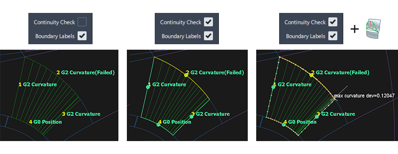

Boundary Labels and Continuity Check

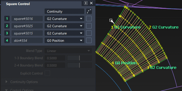

The Boundary Labels are on by default, and they report whether the square surface has achieved continuity to within the Construction Tolerances.
The Continuity Check displays the achieved and failed continuity, using the same colors and decals as the Evaluation > Surface Continuity tool.

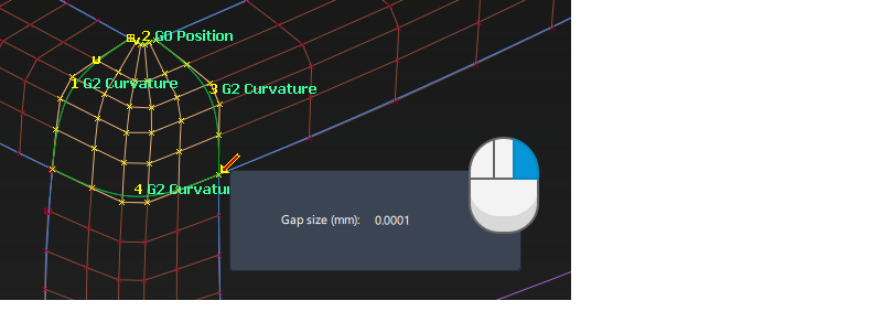

Warning arrow
It is quite common for an arrow to appear at a corner, but for the square surface to still build successfully. The arrow is only a warning not an error, and is displayed for information only.
The arrow appears because the Square and Rail tools use an internal G0 tolerance for some computations which is a factor of 10 tighter than your chosen tolerance. The warning arrow will show any tolerance issues at this tighter value.
Right clicking the arrow displays the deviation between the boundaries.

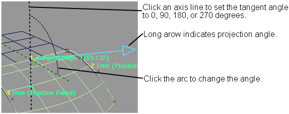

Set a manual tangent angle along an edge
This manipulator only appears when you set an edge to Tangent Angle and the two adjacent edges are set to Free.
- Click an axis line to set the tangent angle to 0, 90, 180, or 270 degrees.
- Click an arc, then drag the mouse left and right to change the angle value, or type a number to set the value exactly.
- When you are finished, click the Go button.

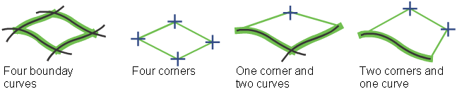

Create a surface using corner points
A square surface can use the following combination of boundary curves/edges and free corner points:
Building from corner points:
- The first corner has to be specified using a snap mode (Alt, Ctrl or Alt+Ctrl).
- After the first point, click the remaining points (corners) in clockwise or counter-clockwise order.
- After the surface appears, you can move a corner locator by dragging it.
Combining Curves and points:
- If you mix curves and corners, you must click the curves first.
- To select a point ona boundary (instead of the boundary itself) use a snap mode (Alt, Ctrl or Alt+Ctrl). These work in UV mode, so CTRL will snap to an edit point or isoparm, and Alt will snap to halfway between.
Trouble-shooting continuity failure
There are several techniques to try when Square does not produce the intended results:
Experiment with the rebuild settings for each boundary. For example turn Rebld on for all boundaries with trimmed surfaces or curves on surface, and recalculate the surface.
Check the continuity of the surrounding surfaces if used as input boundaries. The square won't be able to achieve a hgigher continuity level than exists between the input surfaces or curves and surfaces.
If any of the boundaries are not required to be exactly G0 position, choose Free instead. This relaxes the constraint on that edge and allows other boundaries to have priority.
Use Explicit Control to override the degree and spans chosen by the square tool. Make sure that the continuity is evaluated (for example by turning on Continuity Check in the Control Options) as this is now under your control depending on your chosen explicit settings.
Set the Blend Type to Linear instead of Cubic.
Adjust the influence sliders to adjust the shape of the resulting surface.
Verify that the square surface doesn’t have a corner where the U and V edges are colinear.
