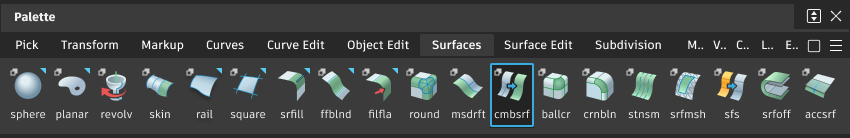

Access the tool from the Surfaces Palette:
