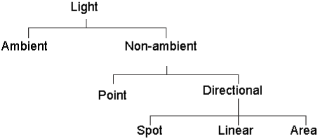

The light classes are derived as follows, where a class inherits the functionality defined in the class above it. The user can only instantiate ambient, point, direction, spot, linear and area lights.
