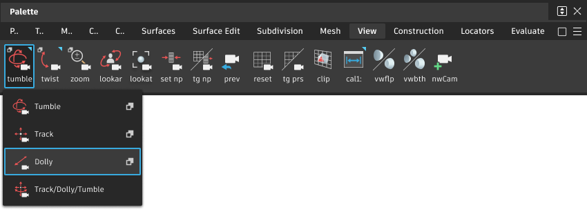

Dolly
Moves the view forward or backward. This tool lets you set certain options more precisely than the View Panel or Autodesk® ViewCube®.
Access this tool from the View palette:
