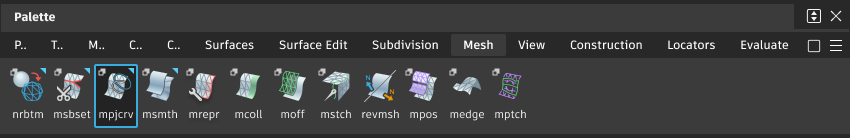

Access this tool from the Mesh tool palette:

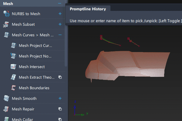

Mesh Project Curves workflow
Select the Mesh Project Curve tool.
Select one or more meshes, and press the Go button.

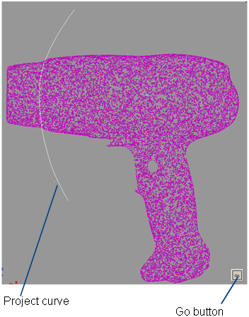

Select:
the curve(s) you want to project, in the view window that is perpendicular to the projection direction OR
a projection vector, then the curve(s) you want to project.
Press the Go button in the lower right hand corner.

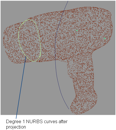

Degree 1 NURBS curves are created on the mesh(es). They update if the input curve is modified.
Note: These projected curves are often referred to as curves-on-mesh.
