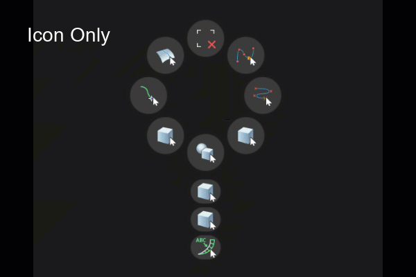

Marking menus are tool shortcuts that pop-up at your cursor position when you use the Shift + Ctrl keys and the mouse buttons.

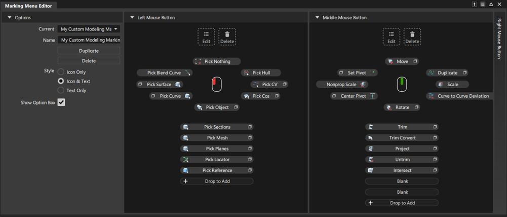

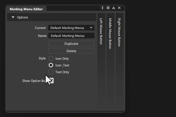

You can choose between the following default marking menus configurations, which are based on Workspace, or create your own custom versions.

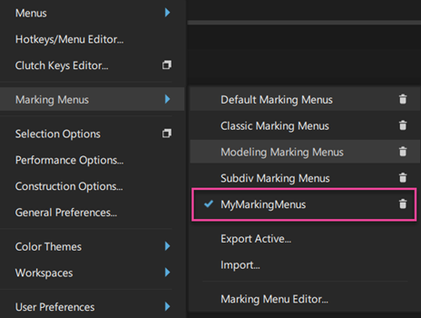

Export Active
Saves the active marking menu to a .json file, which can be shared and later imported.
Import
Loads the selected .json marking menu file to your system. After importing a file, the marking menus appears in the list.
