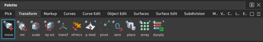

Moves picked items in the scene. The type of item that can be moved depends on which Pick tool is selected.
For example, if Pick > Point Types > CV is selected, Transform > Move moves only CVs. You can change the shape of an object by moving its CVs.
Access this tool from the Transform palette:
