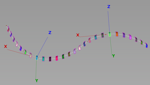

Incremental Rotation X/Y/Z
Rotation around the local X, Y, and Z axes of the duplicates by a relative angle with respect to the previous duplicate. For example, if the X value is 10.0 (degrees), each duplicate is rotated ten degrees more around X than the previous one. This produces a twisting effect along the path.

Orientation
  • None – No change in orientation.
  • Tangent – The first copy of the object takes the original orientation and all subsequent copies are rotated based on the tangent of the input curve at the point where the object is being placed. This allows the arrayed objects to follow the flow of the input curve.
  • Normal – Aligns the local X axis of each duplicate with the tangent of the target curve at the position of the duplicate. If the target curve is a curve-on-surface, each duplicate is oriented so that its local Z axis matches the normal direction of the surface where the curve-on-surface lies. If the target curve is a free curve, the Z axis of each duplicate is oriented along the direction of the curvature vector of the curve (like plot combs).
    Note: If the curvature of the curve changes direction, the duplicates orientation does not flip at inflection points.

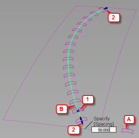

    • A Spacing/Number manipulator also appears, with a Specify label that you can click to toggle between Spacing and Number adjustments. Clicking the numerical value below the label lets you enter an exact value.
  5. Modify the spacing, range, and orientation of the duplicates through the control options. You can also use the manipulators to modify the spacing and range directly on the model.

  7. To set the range, spacing or number of duplicates with the manipulators, some of the options in the control window have a corresponding manipulator on the model.
A: object to duplicate. B: Target curve. 1: Spacing manipulator. 2. Range (Start/End) manipulators.
