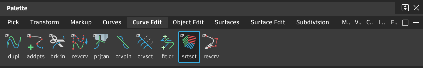

Access this tool from the Curve Edit tool palette:

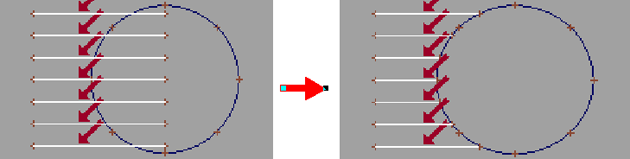

Pick the curves or curves-on-surface you want to trim, in the view window where the curves and the sectioning curve/surface intersect.
For trims, click the part of the curve you want to keep. Red arrows show the “kept” part of the curve.
Click Go.
Click the curve, surface, or construction plane that you want to section with.
