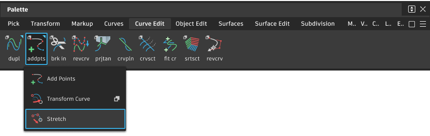

Access this tool from the Curve Edit tool palette:

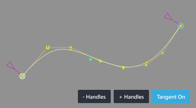

How to use the curve stretch handles
  • To change the number of handles, press the - Handles or + Handles buttons. The minimum number of handles is 2. The maximum number is equal to the curve’s degree + 1. For example, a degree 3 curve cannot have more than 4 handles.
  • To change a handle’s location along the curve, click and drag the purple triangle attached to it.

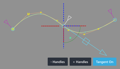

How to use the tangent manipulator
  • Press the Tangent On button to bring up the manipulator on the active handle.
  • Use the manipulator’s arrow head to modify the position of the curve at that point by sliding it along the tangent.
  • Use the manipulator’s square to scale the tangent.
  • Use the manipulator’s dotted arcs to rotate the tangent around the X, Y or Z axes.
  • Use the manipulator’s axes lines to orient the tangent along the X, Y or Z axes.
  • Press the Tangent Off button to remove the manipulator.
