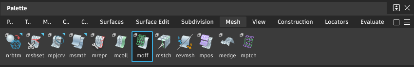

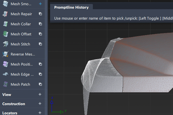

Access this tool from the Mesh tool palette:

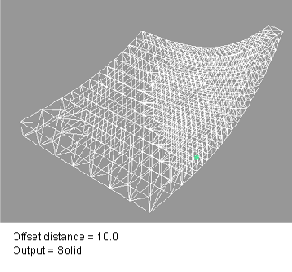

Output
Solid – The mesh is offset and joined to the original to produce a watertight STL-ready mesh. This is the default.
Offset – A simple offset mesh is produced.

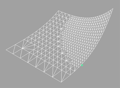

By default, this tool takes a mesh and produces a watertight STL mesh from it (solid).To do this, it first duplicates the original mesh, then creates a mesh offset, removes any problem vertices, and finally joins the mesh offset to the original mesh’s duplicate. To produce a simple offset mesh, you must set Output to Offset in the option box.
