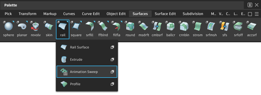

Access the tool from the Surfaces tool palette:

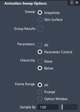

Animation Sweep settings
Sweep
  • Snapshots – Create new curves from the “snapshots” of the animated curve. You can use these curves as construction curves for tools such as Skin, Extrude, and Rail Surface. When Snapshots is selected, Group Results appears as an option for the resulting curves.
  • Skin Surface – Create a new skinned surface from the snapshots of the animated curve.
Parameters
  • All – Animate all parameters of the animated curve.
  • Parameter Control – Animate only the parameters selected in the Animation > Parameter Control window.
Hierarchy
  • None – Only animate the picked curve.
  • Below – When Sweep mode is Snapshots, animate the picked curve and any geometry below it in the DAG. When Sweep mode is Skin Surface, animate the picked curve and associated CVs.
Frame Range
  • All – Animate the picked curve over the entire range of available frames of animation. Use the By Frame slider to set the interval between snapshots.
  • Prompt – Prompt for the start frame, end frame, and frame interval every time you use the tool.
  • Option Window – Set the start frame, end frame, and frame interval once in the option window, for every subsequent use of the Anim Sweep tool.
Start/End Frame
This option appears when Frame Range set to Option Window.
Set the start and end frames of the curve’s animation to create snapshots from.
By Frame
This option appears when Frame Range is All.
The number of frames in each step between snapshots. For example, a value of 1 takes every frame, 2 takes every other frame, 3 takes every third frame.

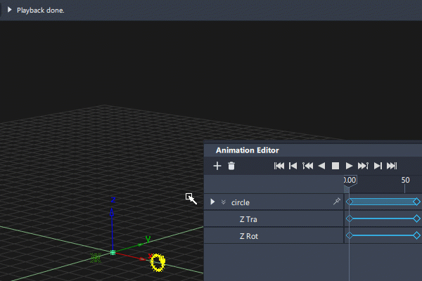

To sweep an animated curve
  1. Animate the curve.
  2. Pick the animated curve.
  3. Shift-select the Anim Sweep tool icon.
  4. If the Frame Range option is set to Prompt, type the start frame, end frame, and frame increment, separated by spaces, on the promptline.
    The frame increment is the number of frames to step through between each snapshot. For example, an increment of 1 takes every frame, 2 takes every other frame, 3 takes every third frame, and so on.
  5. The Anim Sweep tool takes a snapshot of the curve at each step of the animation, creating a series of construction curves.
    • If the Sweep option is set to Snapshots, the Anim Sweep tool asks you whether you want to keep the curves. If the snapshot curves look wrong and you want to change the animation and try again, click No.
    • If the Sweep option is set to Skin Surface, the Anim Sweep tool automatically skins a new surface along the snapshots of the animated curve.
