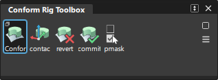

Conform Rig Toolbox
Selecting the Bend Rig icon opens the toolbox:
Conform
Use this tool to select the target objects to be applied to another object.
Contact
the contact point serves as the pivot for the scale and rotate operations. It also defines the placement of the targets after conform. By default, the Conform tool puts the contact point at the center of the bottom of the targets.
Revert
When targets are added to the rig, they are duplicated. The shape modifications are performed with these duplicated geometry. To restore the original geometry and to delete the modified geometry and history, click Revert. Notice that the manipulated modifiers do not return to their status before the dynamic modeling.
Commit
Click Commit to confirm the dynamic shape modification and delete the original geometry and the history.
Show Pick Mask
This tool helps when selecting targets for use in the rig. It is only usable when you pick targets or select Conform destinations.

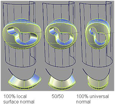

Choosing this mode enables you to determine how the edges of the target maps to the destination. If the value is 0.0, 100% of the local normal of the destination is used. A value of 1.0 means the normal of the destination found at the center of the target is used universally. The result is that the sides of the target appear parallel — hence the name. The default for this slider is 1.0. You can also use the slider to blend between the two effects.

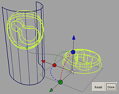

You can move the contact point. In the Conform Rig tool box, choose the Change Contact Point tool. After choosing this tool, you see something like the following:
Using the manipulator, you can move the contact point relative to the targets in their original position. As soon as you change the position of the contact point, the conformed targets update to show the effects of the change. You can also use the manipulator to snap the contact point to a particular point of the original target — click the light blue point at the center of the manipulator. After it turns white, you can use normal curve-snapping techniques to snap the contact point onto any part of the original targets, as shown here:
After you have moved the contact point, further rotation or scale operations within the Conform Rig tool will use the new position of the contact point as the pivot for the targets.
You can also change the orientation of the reference plane. The reference plane is initialized parallel to the XY plane. If your targets have a different orientation, the results of the conform operation may not make sense. Using the rotational handle of the manipulator allows you to rotate the reference plane to make a better fit with the original surface.
In the following screenshot, the target has been rotated so that the bottom no longer lies on the XY plane. If the rotated target is used in the Conform Rig tool as-is, the result of the conform operation is not what is expected. Using the Change Contact Point tool to rotate the reference plane fixes the problem without having to change the original target.

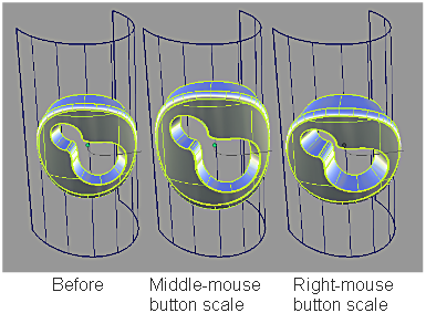

Use the Scale mode to adjust the size of the targets relative to the destination, using the contact point as the scale pivot. Again, if the target is scaled to extend beyond the destination, the tool extrapolates tangentially. Use the left mouse button to scale (click-drag to the left or right) the targets proportionally. Use the middle mouse to scale along the destination surface (making the target bigger but not thicker); use the right mouse button to scale how thick the target becomes.
The surface on the right shows a tall version of the target, and also shows how conform works: by default, it uses the local surface normal to determine how to map the higher parts of the target, and for destinations that are very curved, this introduces distortions by stretching the top of the target because the normal directions diverge.
The Conform Control option window has a Parallel normal mode slider. If the value is 0.0 (as in the left objects of the next screenshot), you use 100% of the local normal of the destination. A value of 1.0 (on the right of the screenshot) means the normal of the destination found at the center of the target is used universally. The result is that the sides of the target appear parallel — hence the name. The default for this slider is 1.0. You can also use the slider to blend between the two effects (the middle objects in the screenshot use 0.5):

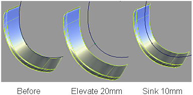

Use Elevate mode to choose to lift the targets up and away from the destination, or lower and sink the target into the surface. You can do so by click-dragging up and down in Elevate mode. You can also type in the elevation value in either absolute mode or relative mode, using the current linear unit.
