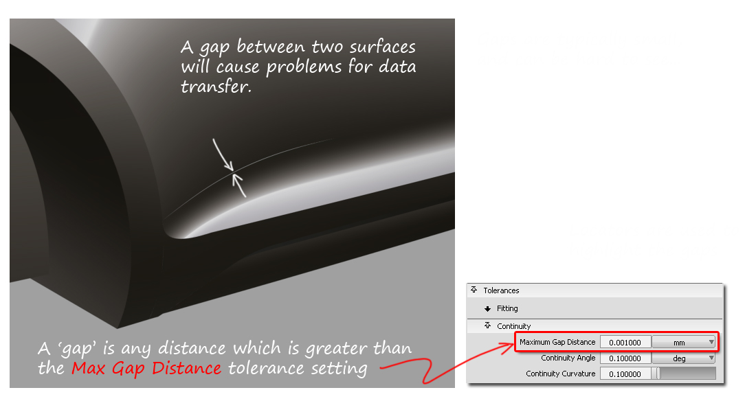

Construction Tolerances determine how accurately matched your surfaces are in your model, and are selected using Preferences > Construction Options.
Surfaces built to the right tolerances won't have any 'gaps' between surface patches that are meant to describe a continuous shape. This is important for creating 'water-tight' models that can be exported into Engineering CAD systems or for prototyping or manufacture.

Maximum Gap Tolerance
There are many different Construction Tolerance settings which can be selected in the Preferences > Construction Options window.
The key setting for data transfer is the Maximum Gap Distance.

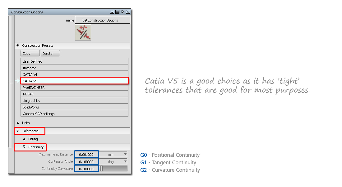

Use Preferences > Construction Options to set the construction tolerances for creating surfaces.
The first section is the Construction Presets. These set the typical tolerances required for exporting out to the most common CAD systems, and are the easiest way to choose your modeling tolerances.
