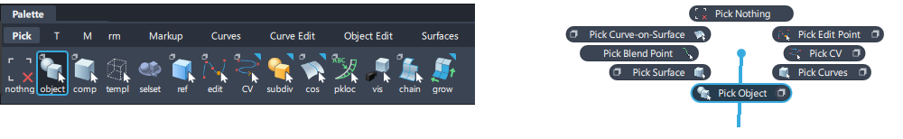

Access the tool from the Pick Palette or from the default LMB Marking Menu:

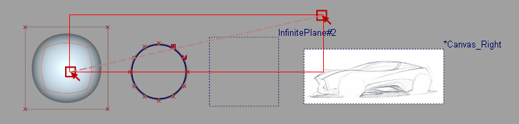

Box-select with click-drag
To select many items, use LMB + click and drag a selection area. Any items partially within the box are selected.
Once selected, choose your next tool (for example Move or Delete).

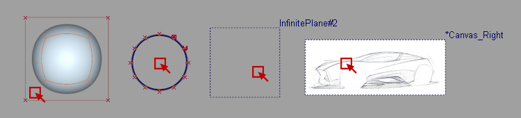

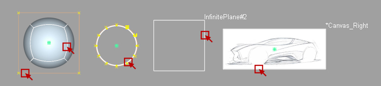

Selecting with click-release
Use a click-and-release gesture to select individual items. The selected item is shown in a highlight color. You can continue clicking to add objects to the selection or remove objects from the selection.
You must click directly on a control element or on the boundaries of objects, except when selecting surfaces and subdivision objects. The cursor must be within a few pixels of the item as viewed in wireframe for the click-release to make the selection.

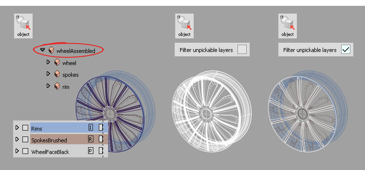

Filter unpickable layers
This option applies when selecting grouped objects, where some components of the groups are on Invisible, Reference or Inactive layers.
- Filter Off: (default) Pick Object will always select all the components in the group hierarchy regardless of the layer states. If items on invisible layers are selected, and Delete is used, a warning message appears.
- Filter Enabled: Pick Object does not select components of the selected group on Invisible, Reference or Inactive layers.

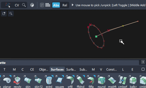

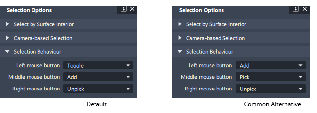

Selection Options - Mouse button behaviour for picking
Pick Object works in conjunction with Selection Options. It is important to check these settings so you know what to expect from the mouse-selection.
By default, the mouse buttons are set as:
- Left - Toggle - Picking an unselected object selects it. Picking a selected object deselects it.
- Middle - Add - Picking an unselected object selects it. Picking an already selected object has no effect.
- Right - Unpick - Picking a selected object deselects it. Picking a deselected object has no effect.
Your selected modes are displayed on the promptline whenever a pick tool is used:
These can be customized using Preferences > Selection Options with each button being assigned one of four options. The default settings and a common alternative are shown below:

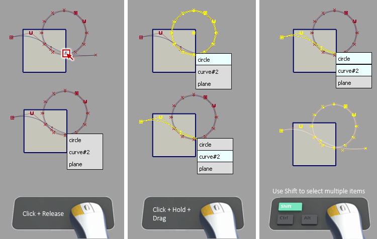

Selecting with the Pick Chooser
If several objects are in the same space in a view window, it may be hard for Alias to determine which object you intended to select. In this situation, when you click-and- release on the geometry, a pick chooser menu appears.
- If you know the name of the item you want to select, you can click directly on it.
- Otherwise click-and-hold on the pick chooser list and move between the names. Each surface will be highlighted in yellow to show what will be selected. Release the mouse button on the one you want.
- Holding down the Shift key when moving through the list keeps it visible so that multiple items can be selected. These items are highlighted in the list, and then selected when the Shift key is released.

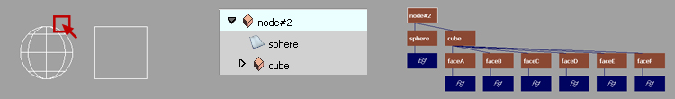

Pick Object and group hierarchy
Using Pick Object in the viewport always selects the top node of a group.
Pick Object in the Object Lister or the SBD window can select any node or sub-nodes within a group.
Although rarely used, the Shift and arrow keys can be used to switch the selection up, down and across the hierarchy.

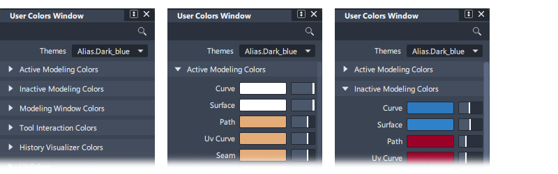

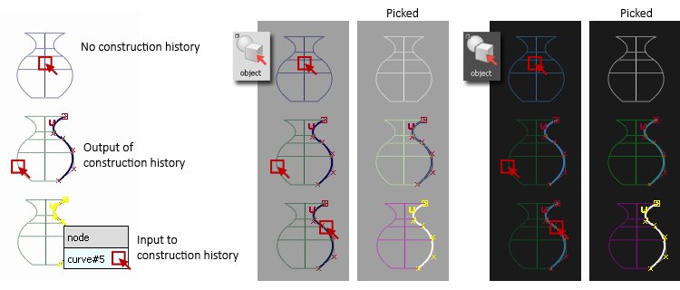

Selected Object highlight color
The highlight color used for selected objects depends on which color theme you are using. Selecting Preferences > Color Themes > Customize opens the Use Colors Window, which lets you see the color theme you are using as well as change the UI colors.
Different highlight colors are used for:
- Objects with no construction history (default white).
- Objects with construction history (default light green).
- Affected items when the input geometry is selected (default pink).
