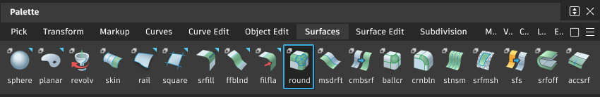

Access this tool from the Surfaces palette:

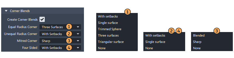

Corner Blends
Create Corner Blends
When on, all of the four settings beneath it are applied to the initial build of the Round surfaces.
When off, no corner is built and the four settings beneath are ignored. Use this if you want to contruct the corners yourself, using the Corner Blend tool for example.

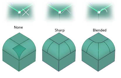

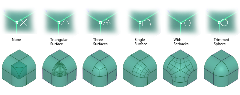

About Corner Blend Presets and the Manipulator Icons
The corner blend settings in the tool window specify the initial corner styles. Once built, the corner styles are displayed as individual manipulator icons on each corner. Clicking on an icon will toggle between all the possible choices for that corner geometry:
  • None – Corner geometry is not created and fillets are not trimmed..
  • Triangular surface – A single surface with one side of zero length.
  • Three surfaces – Three regular (4-sided) surfaces.
  • Trimmed Sphere – A portion of a sphere trimmed to the corner boundaries (G1 Circular only).
  • Single Surface – One regular (4-sided) surface.
  • With setbacks – Six or eight surfaces, with their edges extending into neighboring fillets.
  • Blended – Mitred corner with a blended edge (when only two edges are selected).
  • Sharp – Mitred corner (when only two edges are selected).

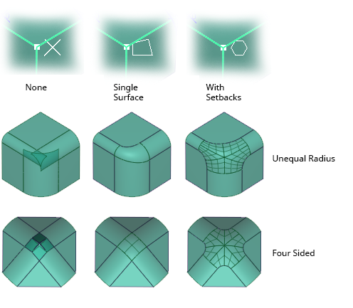

Equal Radius Corner
Specifies the corner geometry when the radii specified along all three edges are the same. Click on the corner icon to cycle through the options, and click Build (or use Auti Rebuild in the Control Options).
Unequal Radius Corner / Four Sided Corner
Specifies the corner geometry when the radii specified along all three edges are different, or a a corner where four edges meet.
Mitred Corner
Specifies how two fillet surfaces meet at a mitred corner.

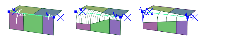

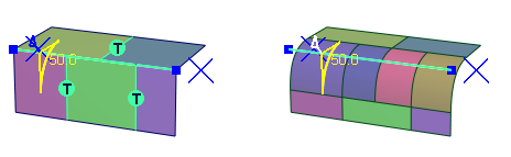

Radius manipulator
The radius manipulators appear when edges are selected for Round. They have two handles, as shown above.
  • Click and drag the large arc to change the radius value or use the keyboard to enter a value.
  • Click and drag the small triangle to move the manipulator along the edge or use the keyboard to enter an exact parameter value between 0 and 1.
Selecting manipulators:
  • Click again on an edge to add an additional manipulator for a variable round.
  • Shift-click to remove a manipulator.
  • Ctrl-click to select additional manipulators and set them to the value of the first manipulator. Once selected they can all be changed simultaneously.
  • Alt-click on a manipulator to select all manipulators set to the same value. Changing the radius value will change allthe selected manipulators.

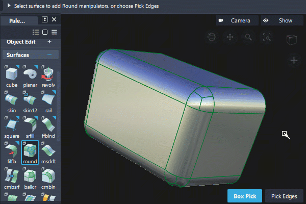

  • Box Pick - Click this to choose Box Pick (box-selection) mode to locate all the edges that meet other surfaces. Edges that do not meet within tolerance, meet tangentially, or where the fillet would have to switch sides, are not selected. If Box Pick is active, individual edges cannot be selected until Accept is chosen (see below).
  • Pick Edges - Click this to select individual edges for rounding.
  • Accept - Click this to accept your current box selection. After clicking Accept, only the Pick Edges selection mode is available to select more edges. To return to Box Pick mode, click Undo All in the Round Control window.

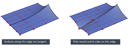

If the surfaces meeting at the edge are tangent to each other at any point, or if the round would switch sides, the fillet will fail.
Note: If the radius specified is too big for the input surfaces, the Round will fail. No error message is given, but the locator remains active for modification.

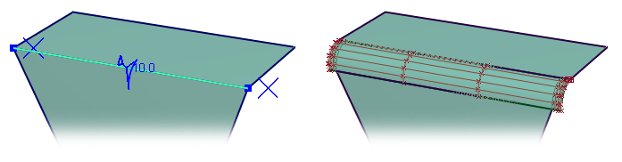

Using Pick Edges
  1. Select the Round tool icon.
  2. Make sure that the Pick Edges button is selected (bottom right-hand corner of the active view).
  3. Click once on an edge to add a radius manipulator. Note that edges must have G0 Positional continuity to within your chosen tolerances. Continue adding manipulators to edges if required.
  4. Click Build, or use the Auto Update option in the tool window.
  5. You can continue to make modifications to the radius or corner manipulators, and use the Build button again, until you move on to the next tool.
  6. To return to the Round and make modifications, use Object Edit > Query Edit. For some changes, you may need to use the Revert button first.

Using Box Pick
  2. Make sure that the Box Pick button is selected (bottom right-hand corner of the active view).
  3. Drag-select across all edges. The Round tool locates all the edges that meet other surfaces. Edges that do not meet within tolerance, meet tangentially, or where the fillet would have to switch sides, are not selected.
  4. If you make a selection error, click Clear Selection. Otherwise, confirm your selection by clicking Accept (space bar for shortcut if Accept is already highlighted).
  5. If any edges need to be added or removed, the tool is now in Pick Edges mode. Radius values can be modified on individual edges and corner styles can be changed by clicking on the manipulators.
  6. Click Build, or use the Auto Update option in the tool window.
  7. You can continue to make modifications to the radius or corner manipulators, and rebuild, until you move on to the next tool.
  8. To return to the Round and make modifications, use Object Edit > Query Edit. For some changes, you may need to use the Revert button first.

Creating variable radius rounds
You can add as many radius manipulators as you want to set the radius of the fillet at several points along the edge.
  • The radius value will blend smoothly between two manipulators.
  • The radius value will stay constant between a manipulator and an edge, when the manipulator is not at the end of the edge.
Use shift-click to remove a radius manipulator.
If two or more edges are tangent continuous, they are treated as a single edge. Creating a smooth variable radius fillet across the surfaces then requires only two radius manipulators (rather than one for each edge). However, the fillet will be made up of a separate surface for each edge.
Note: the manipulators can only move along the edge segment selected, so choose the two end segments for the manipulator to create an end-to-end variable round.
