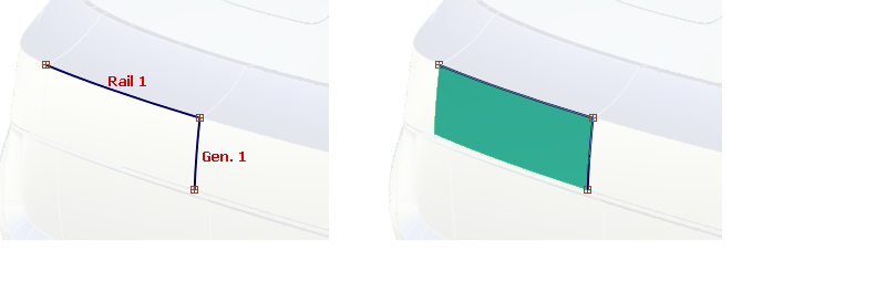

Create a surface by calculating the area swept out by a generation curve moving along one or more rail curves. You can use one generation curve or blend between two or more generation curves.

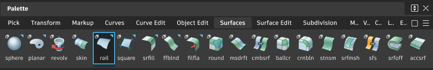

Access this tool from the Surfaces palette:
missing png
Rail settings
Bi-Rail and Mono-Rail were originally separate tools, but were merged because they both had the following common settings.
Generation and Rail Curves
Choose the number of generation curves to be swept along 1 or 2 rail curves. If one set of curves is longer, then these are normally selected as the rail curve(s), and the shorter ones as the generation curve(s).
Follow the prompts to select the generation curves first, followed by the rail curves. If the surface doesn't build, read the prompt message to diagnose the problem, typically one of:

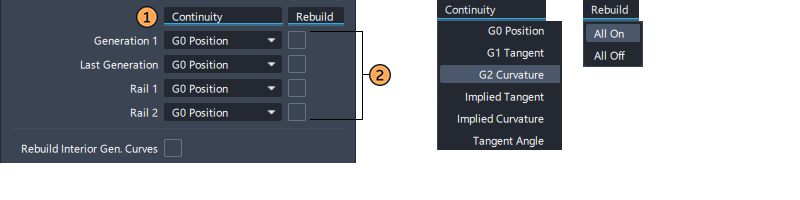

Continuity table and rebuild
The Continuity Table displays one row for each boundary. Use this to select the continuity and rebuild settings:
  • Use the title pop-up menus to adjust the settings for all 4 boundaries.
  • Use the pop-up menu and checkbox on each boundary to adjust individually.
Continuity
Select the Continuity you want between each boundary of the rail surface and the adjacent surface. See Surface Tool Common Parameters for explanations of each continuity option.
Note: If a free curve is used for a boundary, then only G0 Position, Implied Tangent and Implied Curvature are shown, as there is no surface to calculate relative continuity with.
Rebuild

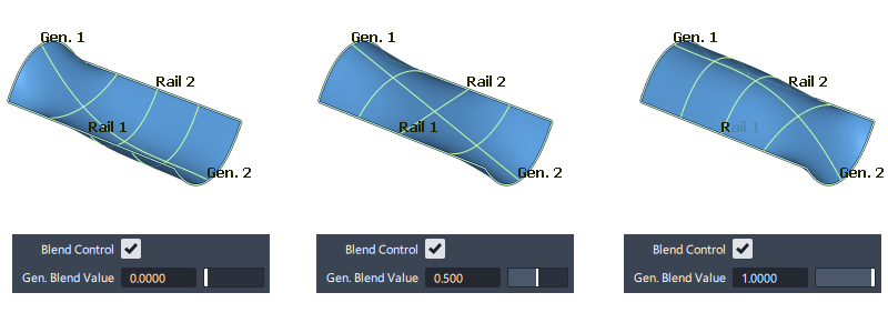

Blend Control (2 generation curves only)
Blend Control modifies the influence of the generation curves over the rail surface shape.
Selecting Blend Control displays the Gen. Blend Value slider to control the midpoint of the blend between two generation curves.(the point where the influence of both generation curves is equal).
  • The default value is 0.5 which blends the two curves equally, so that the halfway point of the blend occurs at the midpoint of the rails.
  • Moving the slider towards 1 gives the Gen. 1 shape a stronger influence.
  • Moving the slider towards 0 gives the Gen. 2 shape a stronger influence.
  • The values 0.0 and 1.0 still blend the two curves a minimum amount.

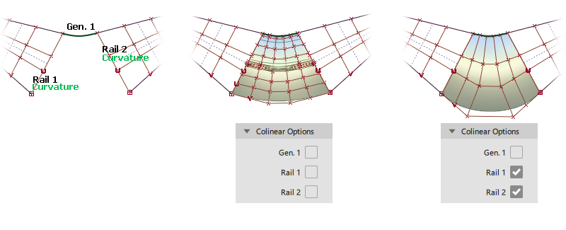

Colinear Options
Select the boundaries where you want alignment with the hulls of the adjacent surface (when using G1 Tangent or G2 Curvature continuity).
Be careful not to use colinear on edges where the CV/hull flow would distort the rail surface being built.
Tip: be careful not to leave the settings on when moving onto another rail surface. If the co-linear options are selected in the wrong circumstances you can get poor results. A good trouble-shooting tactic is to always check that the colinear settings are off, unless you have specifically set them to be on.

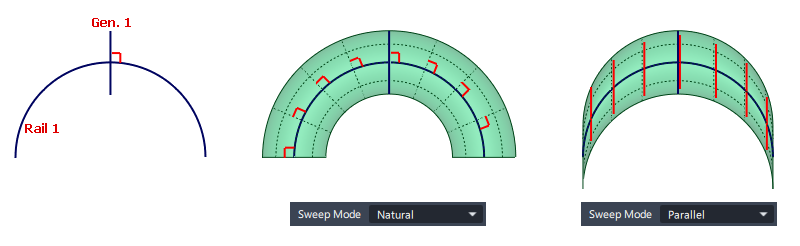

Sweep Mode
  • Natural – As the generation curve sweeps along the rail, it pivots to maintain the same angle relative to the rail curve.
  • Parallel – As the generation curve sweeps along the rail, it maintains its original orientation.
  • View (advanced) – As the generation curve sweeps along the rail, it only rotates in one plane, to maintain the visual angle between the generation and rail curves. Choose the plane from the Sweep Projection pop-up menu:

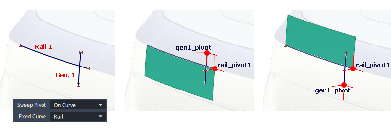

Sweep Pivot
For a mono-rail sweep, the generation shape must connect with the rail curve as it is swept.
If the gen. curve is drawn in the required starting position for the surface, touching rail curve, then the sweep pivots don’t need to be considered and the Closest setting will give the expected results:
If however the the positioning of the input curves is ambiguous, then two ‘pivot points’ are used to control the placement:
  • Generation pivot – the attachment point on the gen. curve.
  • Rail pivot – the attachment point on the rail curve.
Note: These pivots are not related to the Transform Pivot, and only appear whe the rail surface is active.
Use the pivots to specify the point on the free curve that should snap to the specified pivot on the fixed curve:
Sweep Pivot: Closest
The sweep pivots are calculated automatically by finding the closest points on the input curves. The pivots are not displayed on the screen and cannot be modified.
Sweep Pivot: On Curve
Sweep Pivots are displayed on the input curves, one on the Generation and another on the Rail. These can be positioned along each curve by dragging the locator. The pivot labels are only displayed once a pivot is selected.
When the sweep surface is built, the two pivot points become coincident, by moving either the gen. or the rail curve shape depending on the setting for Fixed Curve.
Sweep Pivot: Off Curve
Two Sweep Pivots are displayed, one approximately at the center of the Generation curve and another on the Rail curve. These can be freely moved anywhere in space. The pivot labels are only displayed once a pivot is selected.
The generation curve pivot can be positioned during the input sequence (followed by the Go button), before the rail surface is selected.
Both pivots can also be moved after creation while the surface is ‘live’, however this may lead to unpredictable results, in which case rebuild and position the gen pivot during the creation sequence.

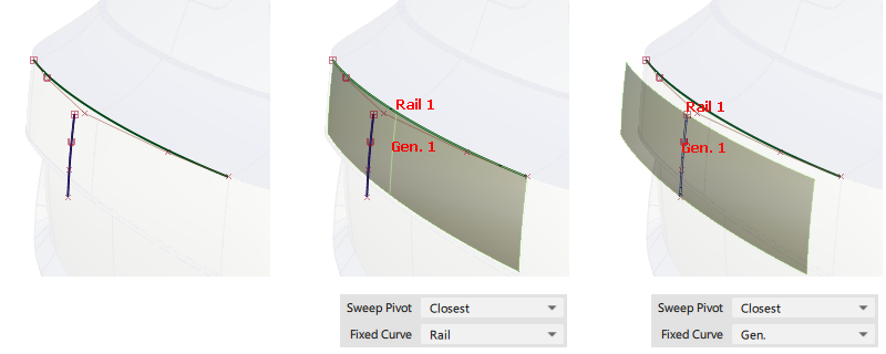

Fixed Curve
This option determines which input curve is free and which is fixed if the curves are not touching.
  • Gen – The generation curve position is fixed, and the rail curve shape is moved.
  • Rail – The rail curve position is fixed, and the generation curve shape is moved.

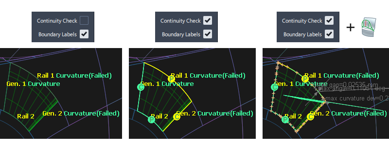

Boundary Labels and Continuity Check
The Boundary Labels are on by default, and they report whether the square surface has achieved continuity to within the Construction Tolerances.
The Continuity Check displays the achieved and failed continuity, using the same colors and decals as the Evaluation > Surface Continuity tool.
Note: To display a comb and/or a min/max values on the Rail continuity check, apply the required settings using the Evaluation > Surface Continuity, Rail will then use the same settings.

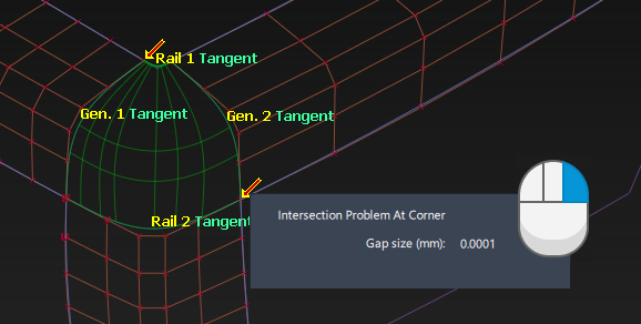

Warning Arrow
It is quite common for an arrow to appear at a corner, but for the rail surface to still build successfully. The arrow is only a warning not an error, and is displayed for information only.
The arrow appears because the Rail (and Square) tools use an internal G0 tolerance for some computations which is a factor of 10 tighter than your chosen tolerance. The warning arrow will show any tolerance issues at this tighter value.
Right mouse clicking on the arrow displays the deviation between the boundaries.
