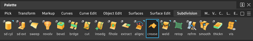

Crease Subdiv Edge
Creates G0 creases along selected edges. Use this tool to create feature lines and hard creases in you subdivision objects.
Access the tool from the Subdivision Palette:
