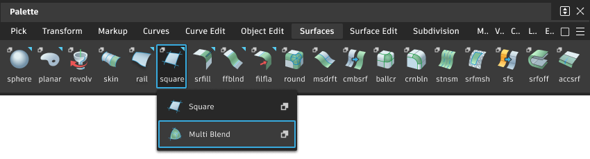

Access the tool from the Surfaces tool palette:

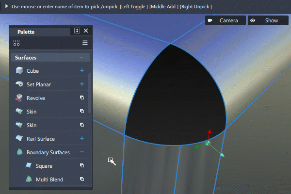

  • Select the Multi-Edge Blend tool and follow the prompts: select the curve(s) for the first edge and hit 'Accept'.
  • A minimum of two input curves are required, so select the second curve(s) for the second edge and hit 'Accept'.
  • A 'Done' button appears. If the two edges you have selected form an enclosed shape you can select 'Done' to finish selecting edges.
  • If you have another edge to select, ignore the 'Done' button and continue selecting.
  • For the third and subsequent edges, continue hitting the 'Accept' button to finish selecting an edge.
  • When all edges have been selected click on the 'Done' Button. The continuity settings for the edges will be displayed on the geometry and can be modified.
  • A 'Build' button now appears, click on this to build the surface.
  • If you are working with the Control Window open, make any required changes and hit the 'Update' button to rebuild the surface. Alternatively use Auto Update in the Control Options.
