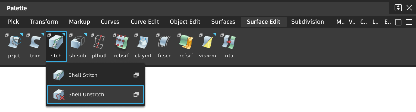

Shell Unstitch
Converts a shell object back to normal surfaces.
Access this tool from the Surface Edit tool palette:
Shell Unstitch Options
Keep originals
Keep the original shell after it is unstitched into surfaces.
Shell Unstitch workflow
  1. Pick the shell object.
  2. Slect the Shell Unstitch tool .
