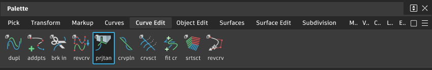

Access this tool from the Curve Edit tool palette:

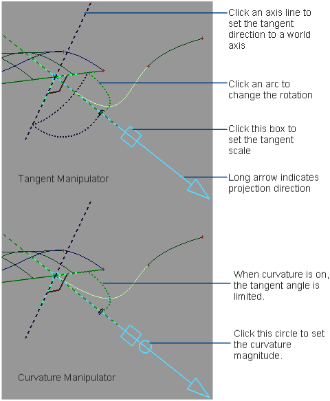

How do I use the manipulator?
  • Click an axis line to set the tangent direction.
  • Click an arc, or the square, or circle (if available), then drag the mouse left and right to change the value, or type a number to set the value exactly.
When you are finished adjusting the curve, click another curve, or choose another tool.
