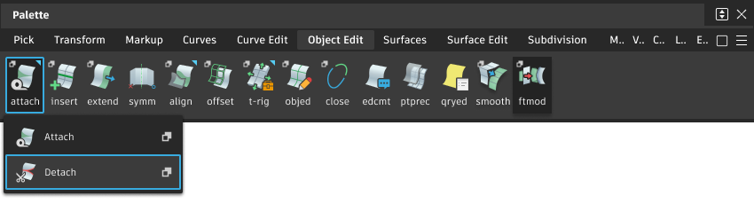

Access this tool from the Object Edit tool palette:
