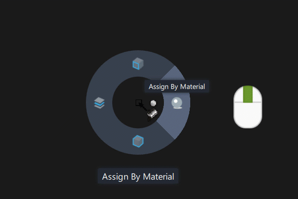

MMB-clicking displays four different options for assigning shaders:
  • Assign By Component - Assign the active shader to a single surface or mesh.
  • Assign By Material - Assign the active shader to all the geometry that use the same material as the clicked geometry.
  • Assign by Object - Assign the active shader to all the components that are grouped in the same object.
  • Assign by Layer - Assign the active shader to all the geometry in the same layer as the clicked geometry.

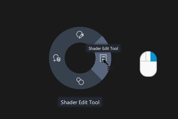

RMB-clicking displays options for performing different shading functions:
  • Make Material Active Tool - Pick a shader assigned to geometry and make the shader active.
  • Shader Edit Tool - Edit the selected shader or texture in the Shader Editor.
  • New From Current Tool - Duplicate the shader assigned to geometry.
  • Add Layer Tool - Create a layered shader and add to it the shader assigned to geometry.

Assign a shader
  • Hold the MMB and drag to select an assignment mode.
Assign by Layer
  1. Assign the active shader to all the geometry in the same layer as the clicked geometry.
  2. Select the shader you want to assign.
  3. With the LMB, click the geometry or drag a box around it.
  1. Hold the RMB and drag to select the Shader Picker tool.
  2. With the LMB, click the geometry that has the shader you are picking. The shader assigned to the clicked geometry becomes active and the tool switches to the last active Apply tool.
Edit the projected texture assigned to geometry
  1. Hold the RMB and drag to select the Open Shader Editor tool.
  2. With the LMB, click the geometry that has the projected texture that you want to edit assigned to it.
    The Shader Editor displays, where you can edit the shader properties.
  1. Hold the RMB and drag to select the Duplicate Shader tool.
  2. With the LMB, click the geometry that has the shader you want to duplicate assigned to it.
    The shader assigned to the geometry is duplicated and then assigned to the geometry
  1. Hold the RMB and drag to select the Create Layered Shader tool.
  2. With the LMB, click the geometry with the shader assigned to it that you want add to a new layer.
    A layered shader is created and the shader assigned to the picked geometry is added to the new layered shader. The layered shader is then assigned to the clicked geometry.
