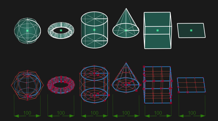

The following NURBS primitives can be created:
  • Sphere
  • Torus
  • Cylinder
  • Cone
  • Cube
  • Plane
  • Place a primitive by clicking in the scene or by entering a co-ordinate position in the prompt line.
  • Primitives are created at a default size of 100 units. Use the manipulator, transform tools or the Information window to change these sizes.
  • The pivot point for the primitive defaults to the center of the geometry (except for the cone which has the pivot at the centre of the base).
  • Primitives can be sculpted by displaying the CVs and using the Pick and Transform tools.
  • Cube is a group of 6 surfaces
  • Cylinder and Cone will be a group if end-caps are selected in the options.
  • Sphere, Cylinder, Cone and Torus will be periodic surfaces when 360 degree sweep is selected.

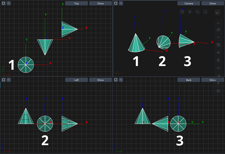

The view window that is used for placement will affect the orientation and the local axes of the primitive as shown below:
  1. Shows a primitive cone placed in the Perspective view and the Top view window, or by typing a co-ordinate in the prompt line.
  2. Shows a primitive cone placed in the Left or Right view window.
  3. Shows a primitive cone placed in the Front or Rear view window.

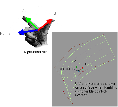

Normals are imaginary lines perpendicular to each point on a curve or surface.
surfacenormals
The direction of U and V isoparms on a surface determines the direction of the surface normals, according to the right-hand rule. This rule states that if the thumb of your right hand points along U, and the forefinger along V, then your middle finger, bent at a right angle from the first two, points along the surface normal.

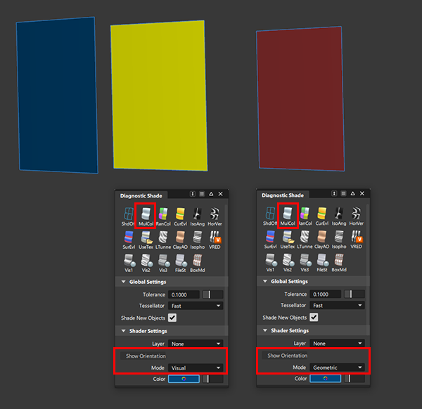

The orientation of a surface—the direction it is facing—is distinct from the U and V directions (tangents) for modeling/evaluation purposes. Changing the orientation of a surface preserves construction history and does not affect texture mappings.
All tools (Ambient Occlusion, Draft Evaluation, Parting Line, Offset) use orientation, rather than surface normal, to determine which way the surface is facing. We provide three tools in the Surface Edit > Orientation submenu to modify the orientation of surfaces. These tools flip the surface without affecting its U and V directions. Hence the orientation might correspond to the same direction as the normal (default), or the opposite direction.
The Multi-Color mode of Diagnostic Shading uses yellow and red colors to show the orientation of the visual normals and geometric normals. When Show the Orientation Mode is set to Visual, yellow means that the back of the surface is facing the viewer. When set to Geometric, red means that the geometric normals are reversed. Once again, this orientation is independent from U, V, and surface normal, as shown in the following image.
Orientation
If the U or V direction of the surface needs to be modified, this can be done with a separate tool (Surface Edit > Reverse Surface UV) which affects the surface normal but does not affect the orientation of the surface. This might be necessary, for example, to reverse a texture mapping.

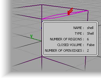

  • To identify open edges in stitched shells:
    Use the Query Edit tool to check for open edges in shells. Red arrows clearly mark gaps in the shell.
