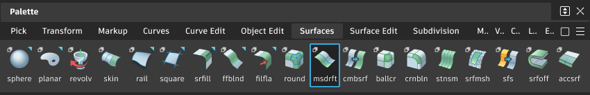

Access the tool from the Surfaces Palette:

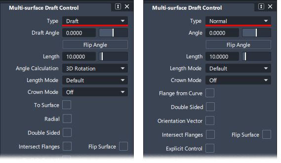

Type
Draft - Creates surfaces from curves or surface curves that all extrude in a vector direction. Adding a draft angle adjusts the direction of the surfaces 'outwards' or 'inwards' from the vector direction, to allow for extraction from a mold, or for design purposes.
Normal - Creates surfaces from surface curves that extrudes in the direction of the normal of the underlying surface(s). Adding an angle value adjusts the direction of the surfaces 'outwards' or 'inwards' from the normal direction.
Draft Angle/Angle + Flip Angle
When the Angle value is zero, the surfaces follow the Draft or Normal direction.
Adding an angle value modifies the surface direction equally in all directions. Use the Flip Angle button to switch between negative and positive angles. (This has the same effect as manually changing the numerical entry with a '-'.)

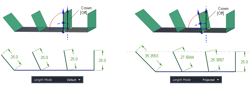

Length Mode
Defines which distance the flange Length represents.
Default – The flange is built to the Length value specified.
Projected – The Length value is used to calculate an offset distance from the input curve, and the flange is built to that distance. If the draft angle is zero, then the default and projected values will be the same. If an angle is applied, then the true length of the flange will be different to the Length value specified.

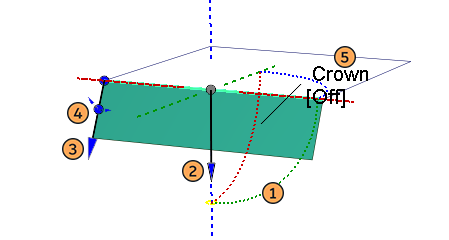

Viewport manipulators
The following settings can be modified interactively using the manipulator:
- Draft vector direction - (Type: Draft only.) Standard vector manipulator (See Surface Tool Common Parameters for details)
- Flip surface - Click on the arrow head to flip the surface.
- Length - Click and drag on the flange arrow to adjust interactively. Click to highlight and type in a value in the promptline for numerical input.
- Angle - Click and drag on the circle to adjust interactively. Click to highlight and type in a value in the promptline for numerical input.
- Crown Mode and Value - See Surface Tool Common Parameters.

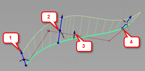

Adding manipulators for variable angle or length values
Additional manipulators can be added using a Shift-click on an input set that doesn't have any tangent breaks. These can be used to create variable angle and/or length MS Draft surfaces.
To work with additional manipulators:
Shift-click the input curve to add manipulators.- Move a manipulator along the curve by dragging the dot at the base of the manipulator.
- Remove manipulators by shift-clicking them.
- Each arrowhead and circle can be clicked to highlight, and a numerical value entered in the promptline.
- Using the 'flip surface' arrowhead will flip all the manipulators.

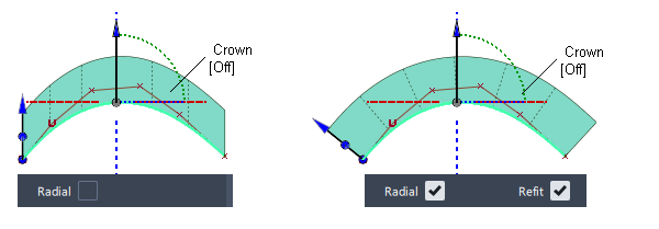

Radial
Selecting Radial orients the draft radially.
Refit
The Radial option creates a variation of the original draft surface. However, the radial surface does not follow the direction of the draft vector, so some radial draft surfaces may not meet the draft requirements. (The surface will fail the draft angle check in the Surface Evaluation diagnostic shader. The larger the angle between the default non-radial draft surface and the radial draft surface, the more likely the draft check will fail.)
To create a radial draft surface that satisfies the draft requirements, the Refit option attempts to refit the radial surface to the original draft surface, while still following the radial directions. It changes the radial draft surface to degree 2 in the draft surface length (V) direction, then aligns the upper row of CVs on the radial draft edge to the default non-radial draft surface, creating a crown. The resulting radial surface is closer to the original and produces better results when checking it with the Surface Evaluation diagnostic shader.

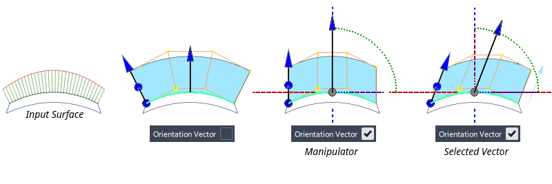

Orientation Vector
The orientation vector allows adjustment of the edges of the flange surface(s). Use the manipulator to select a direction, or choose a vector in scene.

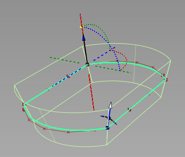

Create Draft surfaces from a set of curves
Create one or more surfaces from a set of profile curves, along a pull direction.

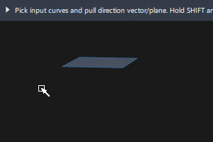

Shift-select the Multi-Surface Draft tool
icon.In the control window set Type to Draft, and choose a pull direction from the Draft Vector Options.
In the Pick Mask section, turn off everything except Curve, so only free curves will be selectable as input.
Box-select all of your curves. The curves can be disjoint (non-touching), G0 (position continuous) or G1 (tangent continuous). You can also pick the curves individually if you want.
The Multi-Surface Draft manipulator appears.
Click the Build button.
The draft surfaces are built.
Do any of the following:
- Change the pull direction by choosing a different draft vector option or by using the pull direction manipulator.
- Change the Draft Angle and Length of the surface(s) through the control window or by using the manipulator.
- Turn on Explicit Control to adjust the control point layout and spans in the U direction.
- Turn on Double Sided to make the surface(s) extend on both sides of the curves.
- Turn on Intersect Flanges to automatically extend and/or trim the draft surface(s) at corners (where the original curves share endpoints).
- Turn on Modify Range and use the Start/End sliders or arrow manipulators to change the extent of the draft surfaces.
Click Update again to update the surface(s), or turn on Auto Update.

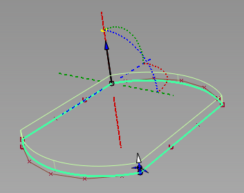

Double-sided draft surfaces with height = 30 and draft angle = 15.

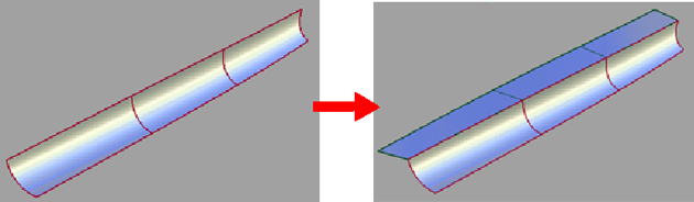

Create Flange surfaces from curves of an existing surface
Create one or more surfaces from a set of surface curves, either along a pull direction, or at an angle relative to the original surfaces.
Double-click the Multi-Surface Draft tool
.In the control window:
- Set Type to Normal to create a flange-like surface, or Draft to create a draft surface.
- In the Pick Mask section, turn on the types of curves you want to select as input (Surface Isoparm, Surface Trim Edge, and/or Curve-on-surface).
- Set Surface Type to Single surface if you want to create a single flange or draft surface.
- Check on Auto Update.

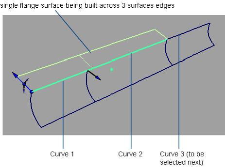

Click or box-select all your curves. The curves can be disjoint (non-touching), or continuous.
As each curve is added, it is highlighted, and a flange surface is built. A single flange surface is created no matter how many surface curves you have selected.
Note: Only G1 (or greater) input curves allow you to create a flange or draft surface of variable height or angle (using multiple manipulators).If you set Type to Draft, you will also need to select a pull vector to specify the initial direction of the surface. (Use the Draft Vector Options or use Construct Vector tool to create a vector object).
Use the manipulator(s) to adjust the flange/draft surface’s length or angle (see below).
You can add or remove curves from the selection, while in the tool, by clicking them.
Set the angle or length at a point along the surface
Use the Multi-Surface Draft tool manipulators to change the Length and Angle, and to reverse the direction of the new surface(s).
- Drag the arrow head to change the length of the surface.
- Drag the dot at the middle of the manipulator to change the Angle/Draft Angle of the surface.
- Click the Flip arrow head to reverse the surface direction.
Shift-click the input curve to add manipulators. Move a manipulator along the curve by dragging the dot at the base of the manipulator. Remove manipulators byShift-clicking them.

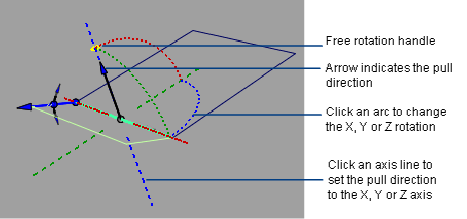

Set the pull direction with the manipulator
- Click an axis line to set the pull direction.
- Click the pull direction arrow to reverse its direction.
- Click one of the arcs, then drag the mouse left and right to change the pull direction.
- Click the free rotation handle to rotate freely in all directions.
- Click an existing reference vector to align the manipulator with it.
