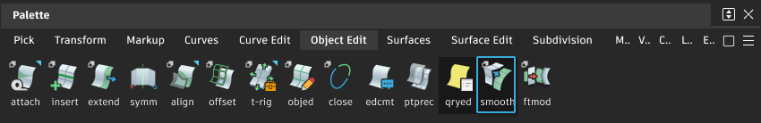

Access this tool from the Object Edit tool palette:

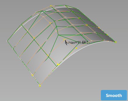

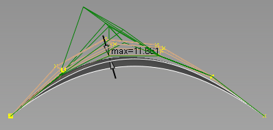

Check Deviation
Displays and updates the maximum deviation between the input and smoothed object after each Smooth.

Select the Smooth tool.

CVs are distributed in a CV network. The position of every CV plays a role in determining the shape of the surface. The relative position of every CV with respect to its neighboring CVs, the lengths of hulls, angles between hulls, and the relative height of CVs from the surface are important factors in determining the evenness of the CV distribution. An evenly distributed CV network results in better surface smoothness.
For surfaces, you can choose to smooth only in the U or V direction.
While smoothing, you can display a proxy representing the original curve or surface (green) and you can display feedback indicating the maximum deviation between the original surface and the smoothed surface (orange).
