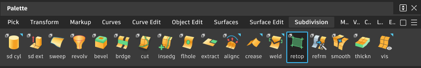

Access the tool from the Subdivision Palette:

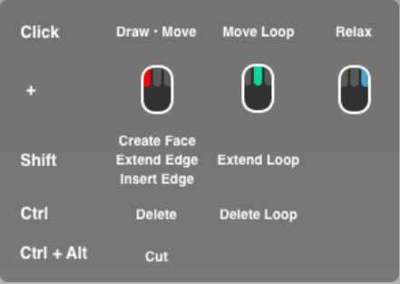

Show Hotkey Help
Toggles the hotkey help overlay image on and off.

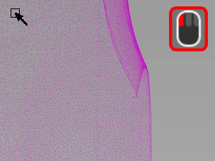

  2. Click anywhere on the reference mesh or object.

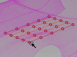

    A green dot appears and snaps the surface of the reference mesh. These dots become the vertices that create the framework for your subdivision faces.
    Tip: You can move a dot by dragging it or delete it by pressing Ctrl + click after you have dropped it on the reference object.

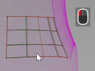

  3. Continue to drop dots until you are ready create faces between them. To do this, move the cursor over the dots while holding Shift. The tool enters face preview mode highlighting the possible faces.
  4. Shift-click a preview face to create it.

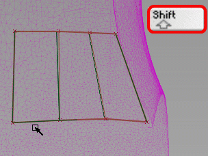

  1. Move the cursor over the edge or edge loop while holding Shift.
    The tool enters preview mode highlighting the edge and edge loop that will be extended.
  2. Do one of the following:
    • To extend an edge, Shift + drag the preview to position the extended edge, then release.
    • To extend an edge loop Shift + MMB drag the preview to position the edge loop extend, then release.

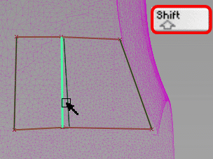

  1. Move the cursor over the subdivision surface while holding Shift.
    The tool's preview mode highlights the new edge.
  2. Position the edge preview and click to add it to the subdivision body.
