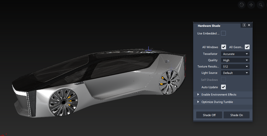

Hardware Shade settings
Use Embedded File Settings
If the file has been saved in Alias2020 or later, Hardware Shade settings were saved with the wire file, and will be used by checking this option.
All Windows
If checked, geometry in all modeling windows is shaded. If not checked, geometry is shaded in the current modeling window only.
All Geometry
If checked, all geometry is shaded. If not checked, only the picked (active) geometry using the picked lights is shaded. If no lights are active, all lights are used.
Tessellator
  • Fast – Tessellates more quickly and less accurately.
  • Accurate – Tessellates more accurately and more slowly.
Quality
Controls how accurately surfaces are tessellated. Choices include Low, Medium, and High.
Choose User defined to control how accurately surfaces are tessellated using the Tolerance parameter (see below).
  • Tolerance - Controls how accurately surfaces are tessellated when Quality is set to User defined. The slider range is 0.001 to 0.1 cm. The default value is 0.005 cm.
  • Show triangles - Overlays the surfaces with triangles used for tessellation. This option only appears if Quality is set to User defined.
  • Limit edge length - This option only appears if Tessellator is set to Accurate and Quality is set to User defined.
    If checked, a Max edge length slider appears. If unchecked, there is no limit on the size of the triangles.
  • Max edge length - Specifies the maximum length of any triangle edge (in current linear units).
Texture resolution
If you are using textures, you can use approximations to speed the computations in hardware rendering. Texture maps can be rendered at the following square resolutions: 128, 256, 512, 1024, and 2048. You can also turn off texture maps by choosing Off from this pop-up menu. A texture map should not be larger than the size the rendered texture will appear to be. For example, if a label in a finished rendering is to be about 256 x 256 pixels square, it is a waste of computational power to use a texture map and a texture resolution that is greater than that value.
Light Source
  • All Lights – Shade surfaces using the lights in the scene, up to a maximum of eight.
  • Selected Lights – Shade surfaces using any picked lights, up to a maximum of eight.
  • Warm Cold – Shade surfaces using a preset combination of warm and cool colored lights.
  • Contrast – Shade surfaces using a preset combination of lights to create a wide range from highlights to shadows.
  • Default – Shade surfaces using a direction light at the camera and an ambient light. This is the fastest option. This option may be hardware accelerated.

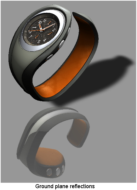

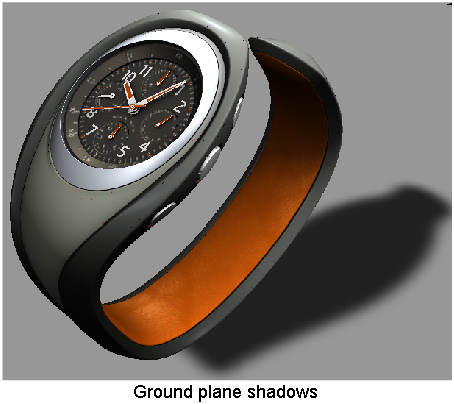

Ground Plane
Enables ground planes, ground plane shadows, and ground plane reflections in hardware shade mode. Options are found in the Ground Plane section of the Environment editor.

Ground Plane Reflections
If enabled, ground plane reflections are approximated while camera operations (track, dolly, tumble) occur, and are updated when the mouse button is released.
