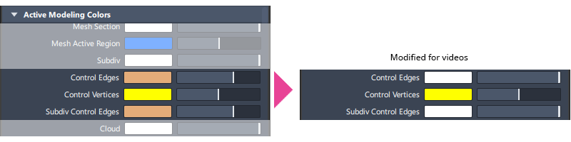

Note: in the dark color themes, the default colors for edges and faces have been lightened to show more clearly in these videos:
