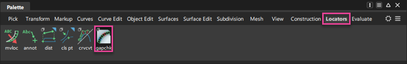

  • The tool has been moved from the Evaluation tool palette to the Locator tool palette.
