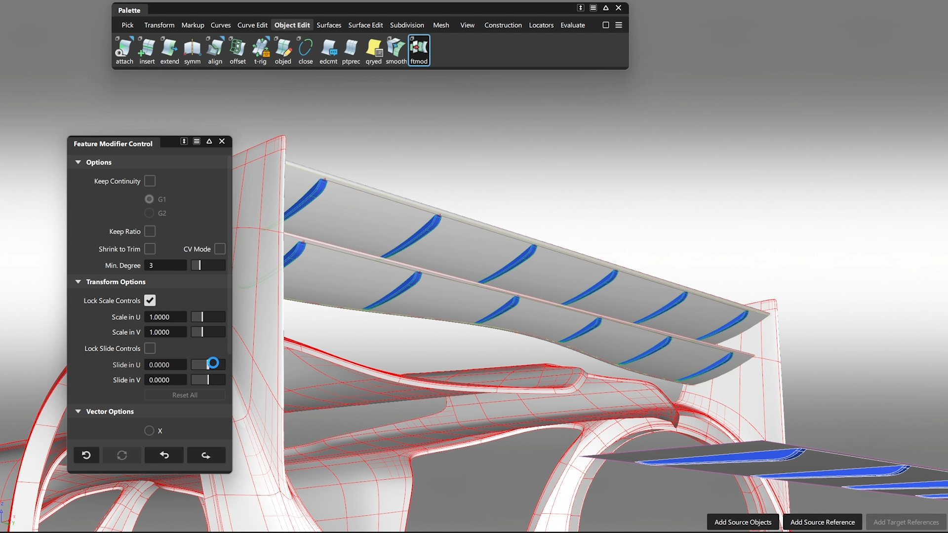

  • We are, for example, introducing a brand new tool, we call the Feature Modifier.
  • This can transfer a feature from a flat surface onto another surface like this logo, which we call the feature which I place onto a curved surface while keeping all connections and continuities.
  • In the past, if you wanted to model a feature like this onto a curved surface, it would have taken a very long time.
  • Now, however, with the Feature Modifier, you can align it to a new surface in one go.
  • Here are some other examples of the Feature Modifier.
  • Like on this back wing where I can distribute the feature along the wing.
  • Or grill patterning where you can transfer the planar squares of a grill design onto the curved surface.
  • And the best is if you have for example, a detail of the grill like this, you can easily copy them onto the other surfaces.
